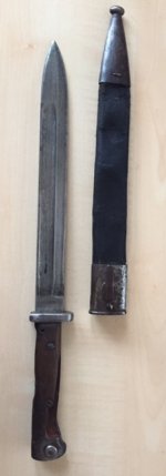

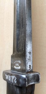

Bayonet for the rifle
Hello together,
sure this thread is very old but I thought it may be interesting for you guys.
This is a matching numbers Seitengewehr 84/98 alter Art or bayonet 84/98 old pattern. Produced by C.G. Haenel Suhl Preussen. Stamped W87 in the back on the Blade.
It's marked to the Jäger-Bataillon Fürst Bismarck (Pommersches) Nr.2, Radfahrer-kompanie, Waffe Nr. 31.
As I was told by a fellow member of the german edged weapon forum (Deutsches-Blankwaffenforum) the unit markings on the bayonet are the early type of Radfahrer markings, 2. J. 6. 31.
On 10.01.1913 every Jäger-Bataillon was equipped with 2 more companies. A 5th. machine gun company and as the 6th. company a Radfahrer company. So for a very short period the unit markings from the Radfahrer company would be the 6. company and not the "typical" R used later.
The sheath was replaced later and marked according to regulations with 2. J. R. 31. matching to the bayonet.
Hope you like the pictures and with best regards
Vincent

That is a nice bayonet, you should also consider posting it in the bayonet forum? This one deserves being seen!
Hello,
thank you guys for your nice words. It really is a very interesting piece and as far as i know the only bayonet with Radfahrer markings.
If you are interested i can post it in the bayonet forum as well.
With kind regards
Vincent
