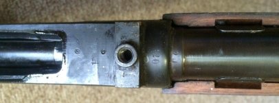

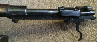

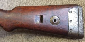

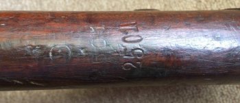

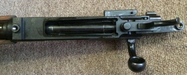

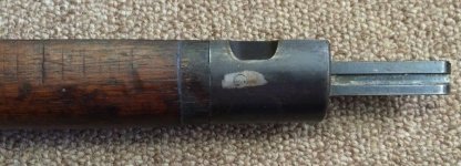

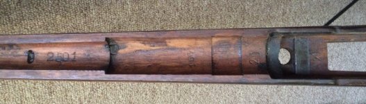

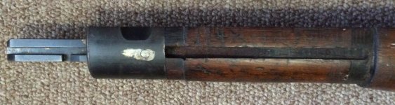

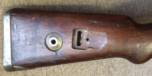

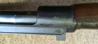

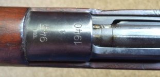

    Interesting HZa rework. Vet bringback with interesting provenance, from the vet's family. The HZa inspection is on the wrist. Bolt was replaced from another G.33/40 and numbered to this one on the stem. Old numbers are on the back of the handle in the normal spot. Highlights are:
    - Seems to be old remnants of scrubbed whitewash on the stock
    - New rework numbers on the stock under the original ones, which match
    - Cleaning rod replaced with a cut down K98k rod; I've seen this on reworks with the early rods, so it could still be stacked
    - Notice the "2" stamped on the receiver
    - Need to take off the handguard to see if it is rebarreled (bolt and sear replaced, which usually indicates new headspacing, new brl)

    Thanks guys. What is also odd is that you can tell it has not had a hood on it, perhaps no hood since rework. This is the first G.33/40 rework I've run across. I feel pretty sure that the traces of old white all over the stock are old whitewash. The thing was likely broken/damaged, perhaps battlefield salvaged, maybe on the East front, then transferred back to the west with a unit or for rework. It's very unusual, just like I like them ;)

    Nov 2010
    1,841
    Quote Originally Posted by Hambone View Post
    I recall Bill Grist having a gun that was pretty clearly whitewashed on the wood, still had most of the finish. K98 maybe? Hopefully he chimes in.

    Baby Face RyanE's Avatar
    Mar 2010
    AL
    2,178
    Fantastic rifle. Depot inspection appears to be HNZaInn4.

    Default G.33/40 945 1940 HZa rework
    It is a Gebirgsjäger (mountain troop carbine)... Crete, the Balkans, Norway or Austria are more likely... I personally own a G33/40 captured from the Gebirgsjägers in Norway... It has one of the most slick and smoth actions of any of the many Mauser-type-rifles I have ever handled...
