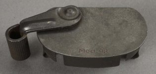

    I Like Bunnies ditch68's Avatar
    Mar 2011
    AZ
    1,020
    Great post as it ages...
    I'll add my latest here, eeu43. Original, but backplate is likely from an ofh trigger.
    Jeff
    Collecting latewar K98k rifles and snipers and scopes, and WWII German 6x30 binoculars.
    INFANTRY! FOLLOW ME!
  9. #9
    Jan 2010
    74,433
    Jeff, my backplate on my tpe is different, more blue dipped, than the rest, which is phosphate. I wouldn't be concerned on yours (nice piece) as it is likely original like that.

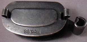

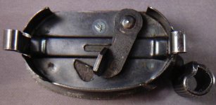

    Default Winter Triggers -originals and fakes thread
    I thought we should start one of these. I just got this one in trade and have my doubts, but want to be sure. Does anyone really know these triggers? This one is eeu43. On the backplate, the "Mod. 98" is actually upside down? The thing I question is the fit. The backplate is very loose. What do you guys think. If anyone wants to do this, we could post photos of known originals and known fakes. I think it's been too long that this subject has not been clear. Here are the photos of the one I got.
    WTB: K98 rifles that are matching and untouched. See my want list:http://www.k98kforum.com/showthread....ched-condition
