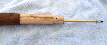

    First, remember that the saw cut removes about 1/16" to 1/8" of the wood. Something has to fill that space because if you butt the pieces up next to each other the front band and bandspring wont fit, neither will the rear band. It basically will look assed up or you'll have to grind and cut on things to make it fit. Also, lining things up is IMPORTANT!
    I found that the 1/4" brass tube length fits right tight in the cleaning rod channel without any drilling and a cleaning rod will pass through it. That aligns your front end and rear end and adds alot of strength. I use ONLY brass as it doesn't rust like steel and is stronger than copper. I use the threaded brass rods because they screw into the wood somewhat and provide more surface for the Devcon. I use a 1/8" bit for the rods, which are 2 1/2" in length, which allows for about a 1/8" gap in the middle and over an inch of rod in each side.

    Once the brass tube lines things up, I punch two marks for sinking the pins in the front half. I then vice the front half (I have rubber vice pads), and slooowly drill down an inch for setting the rods. I wipe the front end with white Devcon hardener (or car wax, whatever), then push it down the rod to touch the face of the main stock cut. This leaves an impression showing where the holes are on the front piece. I then punch them and drilll them out to an inch to accept the rods.
    Note 1: I mark the smaller front piece first as it is thinner and you have less wood to work with than the back. Thus, you want your rods to be in the centers of the thickest sections of the front piece for the most support. MEASURE FOUR TIMES CUT ONCE.
    Note 2: The main stock is viced, rubber pads, and I also put the action back in, and reassemble the bands to make sure my marks are right and everything is square.

    After making sure everything fits right, I check the fit and depth of the tubing and rods by placing them in the main stock, then pressing the front piece over it. I do a dry run assembly, and put the bands back on, and handguard to make sure all is straight and even. Remember, you must leave a gap so the bands go on properly and the bandspring fits.
    Then, I mix up my Devcon and set the tubing and rods in the main stock. Devcon work time is about 30-40 minutes. Once it sets, it SETS, so make sure everything fits right and you are ready. If you notice, I filed shallow notches in the brass tube to give it "bite" in the cleaning rod channel. I also removed the rod nut so as to not accidently Devcon the threads. If Devcon gets on your threads and you screw it into that nut, game over, you'll have to cut the rod out. Also note that I punched and roughed up the face of the stock on either side.
    OK, so now we wait 16 hours for the Devcon to set. Note that I assembled everything AGAIN to make sure everything lines up.
    ALSO, VERY IMPORTANT: CLEAN BOTH STOCK PIECES WITH RUBBING ALCOHOL AND/OR ACETONE TO REMOVE ANY GREASE OR OILS THAT WOULD INTERFERE WITH THE DEVCON BINDING.

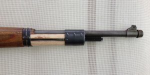

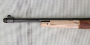

    Final pics. You know, I could have sanded and smoothed what you see to make it blend....but I didn't. It's a dufflecut rifle and that's the mystique to me. That front piece is there to stay.
