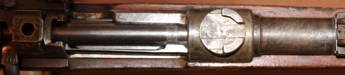

Danzig 1918, # 7956 a, semi turret, all matching
The BC is typical of Hannover jobs, basically ordnance spares, offhand I can't remember if I attributed it to a steel provider. I will add more pictures of the BC tomorrow, have limited time today.

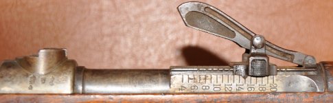

IIRR "LOEWE" identified this one as a Danzig 1917, # 1130 cc,
Bases for Emil Busch, Visar 2 3/4x scope
Thanks for the extra photos Paul. Wolfgang, thank you for all those examples, those snipers I think will be of great importance overall for this study.

I have some photos showing another original claw mount Danzig 1917 with Gl.V. rear sight.
But since I do not remember where I got the photos from, only a part of the serial: 86?? bb

Yes that is mine. It is 8606bb. He however asked about 1918 dating rifles only so I did not mention it.

Thanks gentlemen, at this point I am interested in any rifle with a Gl.V. marked rifle 1916-1918 any info in that regard is welcome. Any 1917 dated example is welcome. My scope was more limited when I first started out, I looked originally at 1918 Dated rifles because they seemed to have the highest probability of having that feature, mainly because it seems that it didn't really begin appearing until the late single letter suffixes for both Amberg and Danzig 1917. I'm not very astute on the total number produced for that year at those makers but going forward I will ask about that info. It would certainly help determine if this is a mid or late 1917 feature.
I saw above the mention of non Gl.V marked 1918 dated rifles it would be great to see those especially from Amberg and Danzig, I think it could help establish a control for this study. I have been using mauser oberndorf seeing as I find a lot of examples, none marked though. Having rifles from the reported makers would help more in my assessment, particularly to see if there is any difference in part acceptance and barrel code.

I have posted detailed pictures of Glasvisier 16 #6000 attached to one of the rifles mentioned in the starting post in the sniper section of this forum: http://www.k98kforum.com/showthread...-Glasvisier-16&p=256844&viewfull=1#post256844

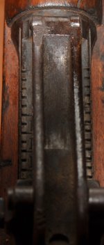

Georg, those are beautiful photos, what is your method for that? Fantastic rifle and optic set, the condition is fantastic and the manual is remarkable. Nice to see one of these on a proper marked rifle.
I think this particular optic is pretty significant. It's the high number for the study which has already surpassed my assumption of five thousand. It will be interesting to see if any turn up higher than this. I have recorded multiple examples from 1-1000, 2k-3k, etc through 6,000, I'm inclined to think that if they were higher I would have seen more dotted examples past 6,000. You very well could have the last one made, but time will tell. I think it's important to not get carried away and let the study guide conclusions and not the other way around, given my assumption has already been proven wrong once.
I didn't know Amberg started bluing receivers so early in their 1918 production, I have Amberg 1918 6507 and it's in the white.
This Glasvisier is on display at the Militärmuseum Sonntagberg in Lower Austria. I don't think the rifle it sits on has a Gl.V. marked rear sight, but can't really make it out. Comes with front sight and original pouch, so despite of the condition quite a "good" ensemble.
Take special note of the "K" marking on the Glasvisier on the main tube. I have never seen this before, anyone an idea on the meaning?

Georg, thanks for the post. Yes I have seen the “K” marking and have it saved in photo references. I’m not sure what it may mean. But I think we should definitely record it when presented. It would be interesting to determine the percentage of recordings that have the marking.

As of right now I have 18 optics recorded ranging from 785-6000. They seem to be very evenly spaced through that range, I have a handful recorded for every thousand.
Out of all, the 'K' only seems to appear on scopes below 1541, the next highest scope I have is 2537 which is not "K" marked. While there is a substantial gap, it will be interesting to see how that mark presents on other early scopes. Possibly those under 2000 were engraved with it. Makes me wonder if these were the optics that were used for the original trial or maybe the first order of optics filled? Hard to say, I can't see any other way why only early optics would be marked like this. I wish someone had a set of an early and late scope for comparison.
Digging with Google it came up with scope #725. With some detailed playing around I got the attached better pics. It clearly shows that this scope also has the K marking. Maybe then a feature of early scopes. Do you have pictures of scope #785 to find out if this scope has these marking as well?
