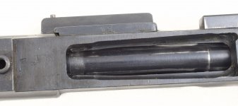

    The rifle started off as a late B series Standard Modell, likely assembled in the 1938-early 1939 time period.
    Originally fitted with a straight bolt and bottom sling, it was converted to full K98k configuration.
    I do not believe the conversions were done at a HZa depot as none bear any depot marks or evidence of depot conversion (ie. Spandau secondary numbering).

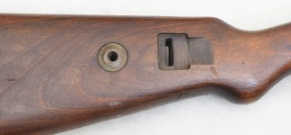

    At some point after the conversion to K98k, the rifle was equipped with a short side rail mount using the early stock "blind routing" for clearing the side mount.
    While SSR examples are very difficult to measure, I am comfortable with this rifle being a legitimate example.
    A secondary issue is how to classify these Banner conversions. I tend to lean toward a Police connection but without documentation its hard to prove.
    Look forward to discussion on this unique rifle.

    Please remove the stock and check the scope base for any pairing serial number on it, either at front, back or on bottom (or on the side, covered by the wood). Also please post a picture of the inletting on the stock since this is only documented by Sauer and rather distinctively made. Is there an additional commercial firing proof on bottom of the barrel, as with the SS rifles?
    Wolfgang once told me Police sniper rifles (according to the official order) carry an additional marking on the receiver (plus required to be from a particular year and manufacturer), what your rifle doesn't. Therefore if it were a Police sniper, it would be one off the line.
    In Robert Spielauers book you can also find Standard Model SSR conversions, but made by the SS with Deaths Heads markings. Maybe your rifle was one of those, but escaped the additional marking (just a guess)?
    Finally, a last thing to point out: the SSR is the very late Type III mount, meaning it doesn't only have the securing screws in the late pattern, but it also has the additional pins plus the hole for the fixture screw from the scope mount atop. These represent the final form of the SSR mount and therefore would indicate being reworked at least in 1943 again. I also noticed miscolorations on the receiver in front of the scope rail which may result from heat.

    The apparent "heat treating"marks on the receiver are simply glare. I have been at this game long enough to know
    if a gun has been messed with. There is a 2 digit assembly number stamped on the bottom of the mount and will add
    images of it, along with the stock routing.
    Of all the snipers, the SSRs are the most problematic, and when he pulled it out of the sleeve I knew this was real.
    Opinions are shared and respected, but thats mine.
    There are no conversion marks on the update to K98k. Among all the examples I have looked at, none bear any.
    They all carry the original MO commerical proofing stamps under the barrel, along with the barrel code.
    B.

    Bruce, I then assume the two digit serial on bottom of the scope base is identical to the one on my ce 43 SSR sniper (click here to see the threat with pictures of it)?
    Re the miscolorations, I only wanted to point those out. It is hard to tell something from pictures. Also the one showing your receiver from top makes it appear as if the side rail has miscolorations too, but this might as well be just smudged oil, but could also be a result of heat (possibly during D&T). It is not necessarily something negative, but just something that should be looked at.
    Xavier, Wolfgang did not gave permission to share more details of what he knows based on original documents/orders of what needs to be done. You might either contact him directly or wait if he will share his knowledge here in public. I do not have a picture of this, to make it short.
