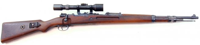

Wanted to post some new Pics of Rifle with its new Mount and Scope . Bruce and I were able to come to an agreement were as he got a Base Turret Rifle and some cash and I got the SSR Mauser Banner Standard Modell . I bought the Scope & Mount at SOS Show this year from a collector who is also a forum member here . I do not want to give his name unless he allows me too , I can not Thank him enough . He was kind enough to part with Scope & Mount so I could complete the SSR Rifle .

I thought scope mount mismatch is below your standard! You should get rid of it :googlie.
Kidding aside, having discussed a lot on these rifles with Xavier the last few days I now really wonder what the correct scope would be for these rifles, and who has used them.
I really like it Dave. Interesting combo for sure. One of the benefits of going to SOS is seeing this stuff in person.
It’s about time you posted this one Dave! When we saw that mount slide onto your rifle and lock up, you ran out of that room like greased lightening!
Oooo That stock is delicious !

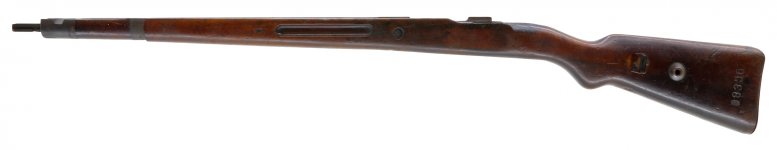

Was at a dealer yesterday, checked junk K98k rifles when another junk K98k rifle (mismatching, reblued, rust pitted) fell into my hands. I first noticed the handgroove stock with the cutout for the bent bolt handle, then really got surprised by the fact that it has a cutout for an SSR base! The price was fair (sum of the parts), hence I nevertheless took it home and finally today managed to take it apart.
Inside of the stock is serialized 77.711, so surely a former Mauser Standard Modell stock. And comparing it with the stock of the rifle in question in this thread here I therefore now no longer see any doubt there was a very late "cutback" SSR conversion on basis of Mauser Standard Modell rifles was outcarried.
