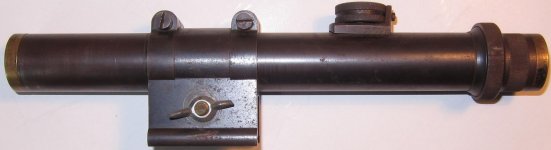

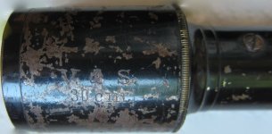

Been some time, but had the chance to buy one of those Long Eye Relief Voigtländer scopes. Based on a period pic that @Amberg had shown me I believe these date to WWI period. Bad on it, it has a damage on ocular ring, seems someone nearly torn off the rear portion. Cool though, it came with a wooden carrying box which also contains an adjustment key. Note the rear scope base is also with it.
It btw came with a Kahles S.F. scope, a really small scope (approx. length of a ZF41, just a little bit larger in diameter) which is also a Long Eye Relief - and has normal adjustment knobs for lateral and side adjustment. Someone polished it, possibly to remount it, what obviously had not happened. I'll check with Kahles, but the logo and making IMHO indicates interwar period. Serial is 25.452, so quite high - I though expect similar to Zeiss that all Kahles scope models were made in the same serial block (so next scope could had been a Mignon or Telorar or H/4x60, ...).

That’s a really neat pair of scopes Georg, I haven’t seen either, I really like them!
