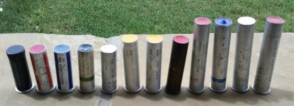

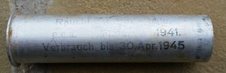

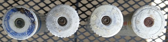

I don't see much in here on German flare guns, flares, and accessories, so I thought I'd post something up that hopefully many can add to.
So first up, flare guns. Germany had a large variety of flare guns, and each service had their distinct models. I have the two most common Army type flare guns.
First up the Heeres Modell developed by Walther, built by several companies. This one is a 1937 ERMA produced gun. Like early 98k's there are a plethora of inspections on this one...

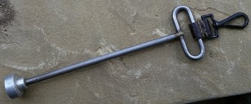

These came with a holster, shoulder strap and cleaning rod. This particular holster, though dated 1941, is an ersatz pressed paper type, although the hinge between the holster body and flap is leather, as is the bellows between front and back on the left side, and the securing strap. Maker marked in ink, bdq 41, with an E/170 WaA….
Shoulder strap that connects to the back via D-rings is leather with steel snap hooks. The cleaning rod is steel with an aluminum head, and has a leather tab with steel snap hook attached. It attaches to the holster by means of a cup the head fits into, and a small securing strap attached to the holster.
These pistols were made of anodized aluminum, were finely finished, and the holster, strap, and cleaning rod made it a fairly expensive pieces of equipment to produce.

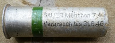

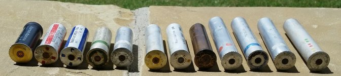

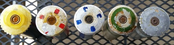

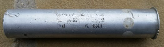

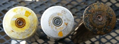

In 1942 they introduced the much simplified Leucht Pistole 42, or LP 42 model. Made of zinc stampings and crudely finished, it did not have a holster, only a lanyard ring to dummy cord it to your belt or equipment. Usually seen tucked into the belt of the user.
Both were standard 26.5mm caliber, and fired a huge variety of flares...
