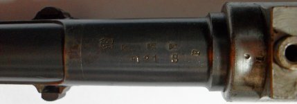

    I actually think it’s the original barrel, given it’s a Bismarckhutte and a low lot number. The firing proof looks right for 1904-1907 time frame. Paul would know for sure on that one.

    I too believe it's the original barrel as well Sam that early style prussian proof matches almost the same on my 1904 Danzig that was also a Depot rework. The only thing different with my rifle is it was unit marked and the barrel was made by Krupp.

    That early Prussian proof is one of my favorites. Looks more like a dragon than an eagle.

    Yeah, agreed! I thought dragon too like a cousin to the Zeithan proof.
