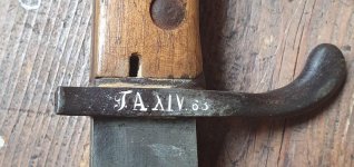

Bayonet S98/05 old pattern:
T.A.XIV. 63.
Korps-Telegraphen Abteilung, XIV Armee-Korps, weapon no. 63

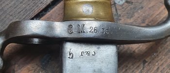

Artillery bayonet 1871
E.M. 20. 36.
Etappen-Munitions-Kolonne no. 26, weapon no. 36.
