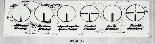

Yes, it can be commercial scope in military use as they were pressed into service because of contract scope shortages. Also here is an official list of reticles used by military:
