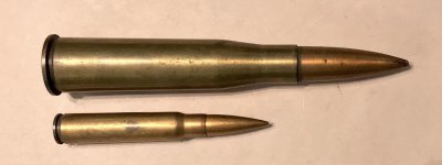

An additional size comparison that might be of interest. Original Tankgewehr rounds are quite scarce and highly collectable as well .....
I was just about to take a couple pics of the same. I've got an unstruck round on my desk. Great minds think alike!

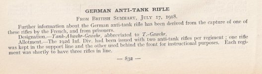

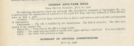

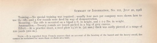

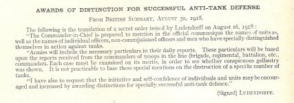

You have to be a stout young man to handle one of these bastards... regarding their effectiveness, I wrote about these about a decade ago, generally using AEF intelligence summaries and period comments. They were very effective if used properly and things were prepared to utilize them, but artillery was the main weapon too deal with tank concentrations. I will see if I can post a few pictures tomorrow from the summaries, they were a common topic when they first came out, the French, English and AEF did experiments with them, testing their effectiveness.
Some early encountered detailed - one Bavarian encounter.
