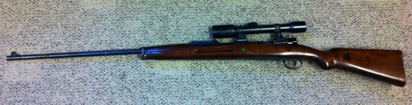

A few photos of my GEW 98 with Ajack 4x90 scope. All serial numbers matching, trying to determine if scope is period correct.

Id say post war done.. never seen a real one where the receiver wasnt cleaned of blue and base soldered on. If the barrel hasnt been shortened it would be worth putting back to orig configuration..
Its sad to see that rare rifle butchered like that..:facepalm:
That is my thoughts as well, not period, but perhaps Wolfgang can offer an opinion.
The rifle itself is very rare, the rarest of Kar.98b made, this rifle extends the range of known rifles considerably, but there is still a gap between this 1700 range rifle and the earliest 1925 (2500 range). If this rifle hadn't been sporterized, it would have rivaled DD example, the finest known I believe. Mine is largely mismatched unfortunately, but I am just glad to own it, as so few have been recorded.
I think this rifle has a lot of potential still, worth a restoration due to its rarity, but someone really chopped 75% of the value off the rifle, at least, with altering the stock and adapting a scope to it.
I will link Wolfgang to this thread, but you (OP) might consider duplicating this thread in the sniper section of this forum. That forum has a very knowledgeable collector there, a friend of Wolfgang's and between the two would know.

What you have is a K98b not a Gew98. A very very rare rifle especially in matching condition, but sadly someone turned yours into a deer rifle after the war. It is hard to look at! Like M99, I doubt very much the mounts are period.
Can you take a shot of the other side of the receiver where the proofs are?

My own feeling is you are technically correct, as the Karabiner 98b nomenclature had not been "adopted" (I use that word loosely) when this rifle was manufactured (happened later in 1925). Still, any rifle made by Simson and dated we call a 98b. This rifle is very rare, and worth restoring properly.
By the way, what is the serial number on the front scope ring, on the side? Looks like a High Turret scope and rings!
As I recall, the first couple years of production, circa 1924 they were still marked as Gew 98 before being marked as kar98b.

Do you mean total Simson 98b production or just 1924? In the book I estimated about 1000-1500 in 1924 (this one raises that number a bit), and by serial extensions it's estimated there were a total of 58000 made. The 98b rifles go up to the late f block. The last of the 98b's were marked Mod.98 on the siderail!
Scope serial is 50265, serial in the forward scope ring is 40274. Any idea on the vintage of the scope? Would like to figure out when the rifle might have been modified, I would assume this took place while it was still in Germany. I have owned it for 36 years and was told it was a WWII battlefield acquisition by the Grandfather of the friend I bought it from.
Scope is from a late wwii high turret. I think maybe someone modified some high turret bases and pit it on the rifle? Certainly not a military conversion imho. I think the rifle was drilled, tapped and scoped post war.
I think the bases are homemade, you can see the uneven, almost homemade look to them. I agree, scope is from a late WW2 High Turret, at least late 1944.
Agreed.
The scope with rings (high turret) looks like an original WWII sniper scope.The bases are something homemade.
The German military always screwed and soldered the bases to the receiver. Only exception: SSR / LSR
I agree that while technically correct, that the Kar.98b designation wasn't authorized until late 1925, these are still Kar.98b because they have the characteristics that differentiate them from the Gewehr98. (side sling arrangement & bent bolt modifications)
Just for clarity on the designations, as per Sturmgewehr, the Kar.98b was originally designated as the Gewehr 98 für Berittene or riders (Cavalry) in May 1924 when production was authorized, later in November 1925 it became the Kar.98b, -this is also when the Modell98 Karabiner (short rifle) became the Kar.98a.
While the designation authorization date to late 1925 the actual SR change doesn't occur until well into 1926 production, when it first goes blank, then picks up Karab.98b around the mid-late "a" blocks (probably 1926 production but by then the dating of receivers drops).
