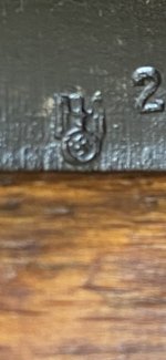

There are no major parts replaced on this, but I am guessing the axle pin was loose and required replacement. No good picture of it but you can see the pin appears to be marked with something. An eagle maybe? Acceptance of some kind? I'm guessing its a spare part.

interesting example... only thing that makes sense is some sort of depot build or repair that would require re-test proofing. As Ryan says goofy looking test proofs do exist and We all the the full KM depot builds that show up.
