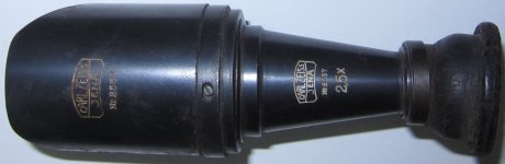

Zeiss Glasvisier serial# 2537

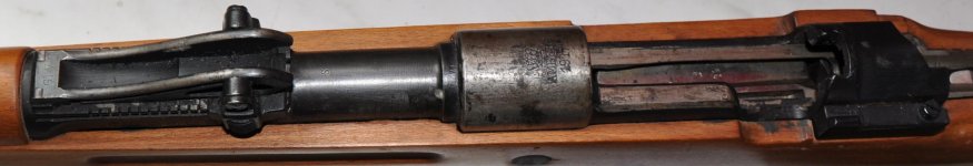

Here is a rifle that came to mind immediately, a restored bond drive (steel plugs in muzzle & breech removed) that was built by CGH in 1915, but subsequently reworked by an ordnance staff, possibly/probably Hannover (or whoever the H-receivers represent, which is still in question**). This subject i have written about before, but the extra acceptance on the RR is a sign of an higher ordnance staff, probably associated with one of the arsenals, but probably not an actual arsenal (they did reworking, we know this because of acceptance, but these with the C/D on the far right RR is probably Hannover due to similarities with known H-receiver production). I think Hannover was working under the supervision or authority of Spandau due to similarities in production methods and the later reliance or take over of Spandau/S&H receivers.
Anyway, this rifle was re-barreled, probably by Hannover in 1917 or 1918, the RS is Gl.V, though not serialed to the rifle (unseriealed), most of the components including stock matched the rifle (bands, TG included), and as a bond rifle it has a pretty good pedigree of originality.
I will take some time to dig through files to further this project.
** I am not convinced H=Hannover, MarkW suggested the possibility and its as good as any other obvious possibility, but although Hannover was an AK HQ in the Imperial era, little else seems to suggest Hannover other than it is part of Prussia and a Prussian facility would have chosen to work with Spandau. Unlike many of the other known collection centers or repair facilities, Hannover was not an artillery depot or munitions depot, other than its role as a AK HQ, its only other task was the riding school (cavalry), hardly an ideal setting to repair and later take over Spandau's rifle production responsibilities... thing is none of the larger artillery depots I saw listed start with an "H" and although it is only a partial list of the 39 that existed, it makes one wonder what this "H" represented??

Wolfgang, would you mind checking your Glasvisier looking into it from the front if there a trapezoid shaped lense visible at the bottom? I've recently been told that some of those scopes should had ended up post WWI in Finland and had been modified there with a new lense and had wondered if this could be the case since in some scopes I have seen such a lense, in others not.
My Zeiss Glasvisier has the split lens (trapezoid shaped lens).

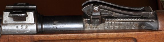

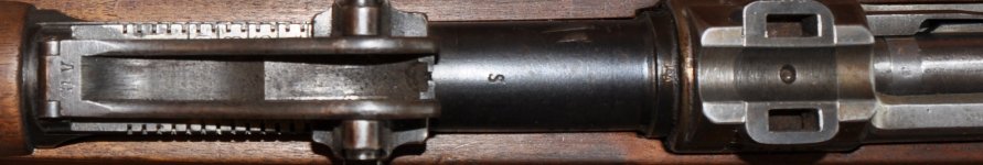

I did not have time to dig out my rifles, but found some old shots.
To take more and better shots will take some time.

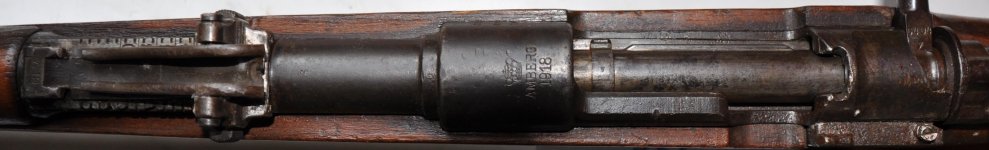

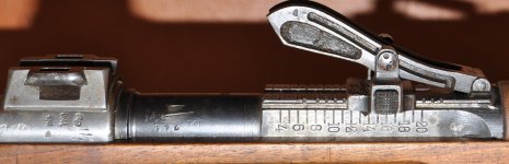

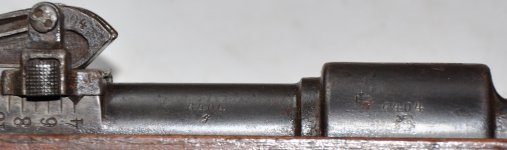

Amberg 1918, # 6404 g, all matching

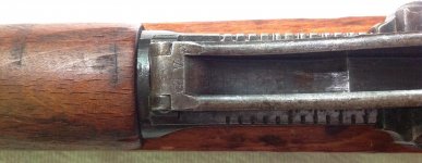

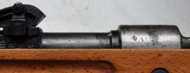

Amberg 1917, # 4879 x, bolt m/m

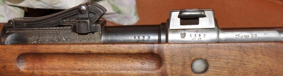

IIRR "LOEWE" identified this one as a Danzig 1917, # 1130 cc,

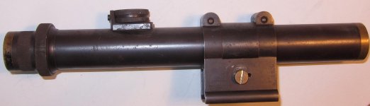

Bases for Emil Busch, Visar 2 3/4x scope
