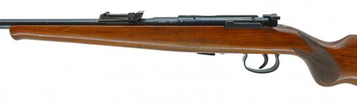

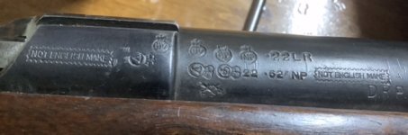

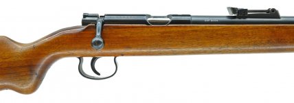

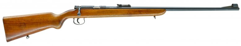

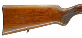

A lot of Mauser .22 experts in here, I hope you can help me with my two Mauser .22 rifles. I had to take them among a whole estate and never paid much attention to them, so hope to learn more on them. A friend told me what he thought the model designations were, can someone confirm if they are correct?
First one is a single shot rifle with a longer and heavy barrel which I've been told is a ES430B. It still has the Mauser logo on the stock, the metal buttplate has the same Mauser logo on it. I originally took the 459 on the barrel for the proof date, so April (19)59 (which doesn't really fit with the pre war proof, I know), but I've been told this is incorrect. What do they mean then? Also found a stamp on the barrel at the front, shown in the last picture.

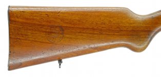

Absolut
Second is what I've been told a MM410B rifle, multi shot with a detachable Mauser marked magazine. This one also has the Mauser logo on the (bakelite?) buttplate. Stock has additional checkering in the grip area, is this original factory? Mauser logo in the stock is stamped as yesterday.
When were these rifles made approx.?

mauser22
The first one is an ES340B.
The "459" refers to the bore not the proof date.
The second is an MM410B

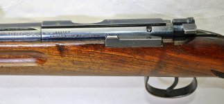

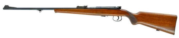

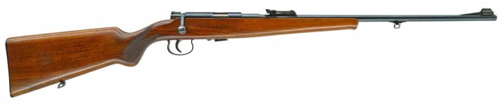

Hello Jim,
Good that I found this topic on the K98k forum. I just posted some info on this ES340B rifle with grooved barrel on RFC forum.
I also have a rifle like this in my collection. See pictures. It's a nice example that I found in Germany this year.
This month I will take it apart for cleaning and further research. You can add the serial number in your charts.
If I found strange things I will let you know. It's a very nice rifle and I'm curious how it shoots after all those years.
You already got more info on the K letter? I also asked a Dutch Mauser pistol collector if he knows something about this K letter.
Enjoy collecting this fine rifles!
Alb.

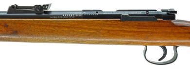

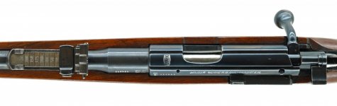

mauser22,
Today, I had a closer look to the "grooved barrel" MS420N. I measured the barrel length, from the action to the muzzle and got 664 (sixty four) mils; I measured as well an ES350B and found 654 (fifty four) mils; got the same value on the "grooved barrel" ES340B. The B serie's barrel lenght given by mauser is 680mm (including ±25mm threated inserted into the action - the measurements, that I made, make sense). My opinion : "N" serie's grooved barrel is neither a "un-numbered" ES350B one nor a ES350N one (see below)
I have 3 of the grooved models, an es340n, an ms420n and an es340b of which you have the number listed. The sights look identical til you look at the method of attachment. The “n” models sights are slid on from the rear of the receiver , both the attachment rails are solid and continuous. The es340b sight is placed on its rail using the cutouts in the rail, its sight has to have cutouts that corespond to these cutouts. The “b” sight can be used on the “n” models but not vice versa. ( can be slight variations in the tolerances of course)
The barrels on my “n” models are the heavier profiles of the 350n
oldwing,
I also measured (from the action to the muzzle) a ES350N (rotate safety) barrel and got 634mils; if the profile looks the same the lenghtes are different . Could you please either confirm or infirm my measurements by measuring your ES340N, MS420N and ES340B grooved barrels lengthes
mauser 22,
in your archive, do you have any evidence that, sometimes, Mauser company did outsourced its barrels?
Kind regards
oldwing
eurydice, I measured the barrels of my 3 grooved barrel variants along with a typical ES350B and a ES340B , The measurements are shown in the photo. Simply used a tape measure and measured from the action to the crown. That is interesting that your ES350N has a shorter barrel. Edit.. I just measured an ES340N and it has about the same shorter measurement as your ES350n . Your opinion that these are not simply un-numbered ES350N barrels seems to be valid .at leasB69C5C47-5727-4D7A-923F-832840D24342.jpegE8885951-F322-4C6D-94CB-819D8433CB71.jpeg
