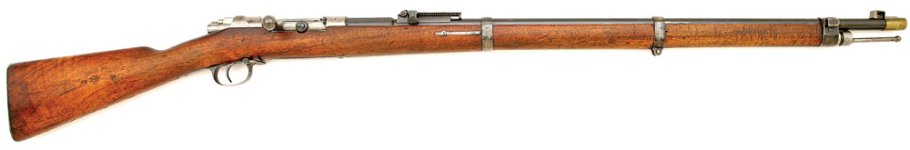

Hi guys,
I snagged this one back in March and took it down last weekend for pics. It was priced aggressively by the consignor, who clearly knew what they had. On the flip-side, it's fairly hard to find these, so it was a "I've got the money, screw it!" purchase.
As I mentioned in a prior post, the WMO 71/84 was only produced for the Württemberg. A contract was executed with Mauser and approximately 19,000 were delivered. According to Storz's work, production was completed in 1887, and despite further need by Württemberg, no more were produced as Mauser was swarmed with the large Ottoman contract for 500,000 rifles. The Württemberg 71/84s bore the c/W cypher on both the barrel and stock (for King Wilhelm of Württemberg). This, like most of the other surviving examples, came toward the end of that contract.
This particular rifle was part of CB's collection, but was never properly photographed and documented. It completely matches and is in wonderful shape, other than a few blemishes (missing front sling loop) and a crack on the stock fore-end. If you look closely you'll notice the odd SN conventions these have compared to the Prussian ones (3-digits rather than 4 on some parts, etc..) I am uncertain of the meaning of the "64" near the buttplate tang. I thought possibly a museum inventory #.
The unit marking is to the Ersatz battalion of IR 121. The muzzle cover is a Bavarian one, but it serves the purpose. I also have an M83 WMO Revolver that is also marked to the 121st, so they make a nice set.

A wonderful rifle in hands Craig would have chosen to inherit.... CB died amidst writing the introduction to the 71/84 for the research thread he authored. i searched emails for reference to this rifle but only early referenced is the Amokeag sale:
1328. German 71/84 Bolt Action Rifle by Mauser Oberndorf
Click on images for enlarged versions.
Zoom
serial #7633A, 11x60mm, 31" barrel with a very good bore that shows scattered light pitting and frosting. The in-the-white receiver and bolt of this 1887 vintage rifle show scattered moderate oxidation staining with the front of the receiver beginning to turn a brown patina and the buttplate shows heavier oxidation staining and some pitting. The blued barrel retains 90% original finish with some scattered light fading and freckling and some tool marks between the two front bands and the bands show fading and freckling with traces of the original fire blue. The lower tang and triggerguard also show fading and freckling throughout with perhaps 40% original fire blue. The hardwood stock rates good plus with a crisp "(Crown)/W" cartouche, as well as other crisp Imperial cartouches, a crisp rack number "64" scattered dings, handling marks, scratches, a 1" chip at middle band, some minor chipping at upper tang and heel and a 6" crack at middle band. All visible serial numbers are matching and there is a unit marking on the top of the buttplate which reads "121.R.E.3.199.". The middle band is loose with its screw exhibiting slot damage and an original brass muzzle cap is included that is marked "BLR/R 252". A very good example that may make a good shooter for the reloader of obsolete cartridges. (207879-9) {ANTIQUE} [Craig Brown Collection] (600/800) SOLD FOR $1,092.50

This appears to be a think unique to this contract-- my earlier Mauser 71s have the full 4 digits on everything.

Pretty much what Sam said-- Allotments were likely made from the Prussian arsenals for 71/84s if there was additional need. On to Gew 98s, the specific pre-war contracts are well documented in the Mauser records. In addition to the years mentioned by Sam, I also have a 1902 WMO marked to the I.R.122. I've also seen at least another Prussian 1904 DWM marked to RJR 123, so very likely a specific allocation occurred with that year.
