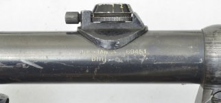

Scope is from earlier 'i' block low turret (Oberndorf) and is good data point for both bmj serial (67051) and also the letter block stamped above the SN.
My 'k' block LT also has a bmj scope (69451) and rifle SN is 33280k.
Application is a bit weird but looks good to me.
