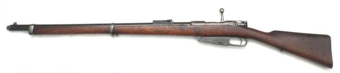

Hi All,
Got this one cheap a couple weeks ago thanks to Cyrus kindly noticing it-- very coincidental there was some conversation around bond 88s shortly beforehand. This one is interesting because it is also a rare, non-turked 88/05--and an Amberg to boot. It's a nice textbook example of the 88/05 features as well. The extra acceptance on the RR and stock are present, the updated rear sight, plug-welded stripper clip guides and the modifications to the magazine are all present. The rifle matches, save for the bolt (par for the course on bond rifles).
As noted in a prior 88/05 post, the lions share of 88/05s were sent to the Ottomans during the war-- part of this included grinding and stamping eastern arabic numbers on the rear sight. Many still in German hands were destroyed post war. I've only seen a handful of 88/05s that retain the German rear sight. Here is another example I posted a while back. This one fortunately had a matching bolt.
The demilling of bond 88s consisted of plugging the bore, removing the bolt head and clipping the firing pin. This one exhibits all three.
For Amberg geeks: Note the assembly number of 109 in a few places.
Not much more to say other than that. Here are the pics:

Thanks goodness for the coalition you guys have formed to help one another! Super nice, added it to trends thread with hyperlink to thread. From recollection that looks like a probable Steyr bolt which is close enough to Amberg! Better than Prussian!
Nice piece of wood on this rifle… kinda crazy for an 1890. The band is really neat on this piece as well. Congrats on the pickup
Thanks Jory, the Amberg 88s are just really nice in general. I've got three 88 rifles (90, 91 and 92) and a rebuild carbine from there. The Bavarians seemed to use a really nice dark stain for a lot of the stocks. It really gives a great character to the wood. Not all have it, but the ones that do just really "pop".

This is an awesome rifle, Chris. It’s personally the only bond rifle made from a gew88 that I’ve seen.
Thanks Sam! 100%. I know of another but they are far scarcer than Gew 98s. I can't recall ever seeing a bond 98a though. I bet they exist.

No, they are tough to find. The original German 88/05 rear sight is a real treat. Pretty rare to see. The Germans ground and restamped the sights prior to export to Turkey. Later on the Turks ground them again and restamped with Western numbers as part of Attaturk's reforms. Those are sometimes mistaken for German sights, but they aren't.

As visible here the barell was replaced, firstly there is maker VCS, and the german proofs are different as on other place of the rifle. The serial 109 is evidently made later as by installing. There is not full old serial number same as is visible traces of barell removing.
Can you expand on this? You said something similar in another thread and I'm not quite sure what I should be looking at here. Are you implying that the stamps and SN were faked, or that they were renumbered as part of depot overhaul, or something else?
I'm not as on the ball with spotting inconsistencies in Imperial weapons as I am Nazi-era rifles, but I'm trying to get better at that, so if there's anything particular you could highlight I'd be both interested and appreciative.
I don't think he's implying it's fake in the least-- I think he's saying it was re-barreled later (possibly as part of the 88/05 reworking, which Amberg was very likely a part of. I agree with him that it was re-barreled.
Of note though, the 109 was not a serial number, but an assembly number (which Amberg was known to do on Gew98s as well) -- note in the photos the 109 appears on the barrel, barrel shroud, under the receiver and on the triggerguard interior.

Sorry i dont known where You get in my info is faked, no its only refurbished in time as the G88 was one of most refurbished of german rifles. As Chris mentioned is rebarelled with S Patrone barell, visible additional inspector proofs on receiver above the older ones.
