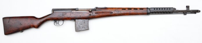

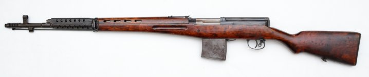

Picked another combat vet (and likely vet bringback) SVT40 up today, and it is quite interesting.
It is a 1941 Factory No.314 Tula from the MK block (more on that later) and is all matching and all original factory finish. No Finnish markings or modifications. Many of the parts, however, are not Tula manufacture. The entire triggergroup is Izhevsk, as is the barrel band, muzzle brake (note the plum color!), and upper heatshield. The bolt is Podolsk as is the plunger lock. Bolt and carrier are blued (correct for SVT/AVT 1942-1945). Receiver is not cut for rails and is the somewhat simplified Type 2.
Given how centralized Soviet production was, seeing other manufactures parts on a rifle is almost unheard of. My almost certainly correct theory is that the MK block is the first block of SVT40 produced at Factory No.314 Mednogorsk, previously located in Tula, in November and December 1941. 9930 rifles were manufactured at Mednogorsk in 1941 (910 in November and 9020 in December) which likely fell in one letter block. The MK guns generally show some or all of the later features--unnotched rear sight, 4 port brake, wide triggerguard,etc.--as well as the abbreviated (i.e., no prefix on the triggergroup or bolt carrier) numbering style used by Mednogorsk on all rifles 1942-1945. The use of parts from the other manufacturers who shut down SVT40 production around the same time Factory No.314 was evacuated to Mednogorsk (October-ish) also leads to the conclusion that this rifle was built very late in 1941, probably December.
