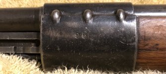

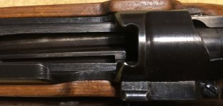

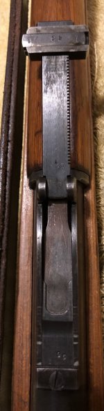

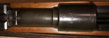

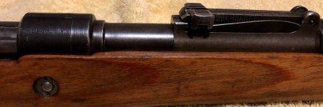

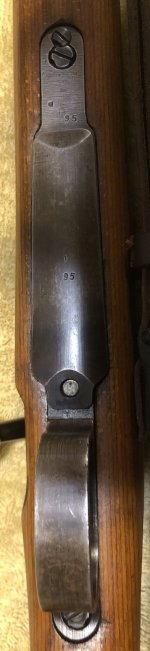

It is not a certainty regarding all aspects so there is that... I do have few pictures of this rifle in January 2001 (attached), not sure if there were more or the context but at least you will have them for research value, wish they showed the band as I am pretty sure they are bad here, generally stamped bands are a 1944 thing for Gustloff Weimar, at least they are Very uncommon (none recorded), even before the e-block (44) they are rather uncommon, wrong serialing style imo too)
Anyway reworks can produce any combination but generally late war reworks are rare and next to impossible to authenticate in any case, the Germans were culling supply and ordnance personal for the front and not usually occupying the battlefield probably account for scarcity.

definitely a different stock in 2001 & now (looking at the depth of the recoil lug) but then Mauserguy85 wrote that he bought it as a barreled action. My bcd 43 3779cc has speed milled & milled bands. (matching less safety)
