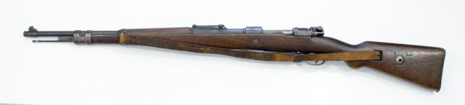

Still dusty. I've been chasing this one since it first surfaced a few months ago...finally got it. It is still as found and not been disassembled. A real combat vet :happy0180:

Congrats to your new Sauer, I really like this one! :happy0180:
I can't see it in the photos, is your rear sight slide lock bar shortened or in original condition? Many rifles got reworked, but not all.
Looks like a great original rifle. I notice the number on the sling buckle. Did not know they were numbered. My dad's 1940 has an L&F stamping. Thanks for sharing
thanks guys! yes this is the first 98 sling i can remember seeing numbered as well, too bad its not to the rifle.
8x57- heres a shot of the rear sight. I see no signs of rework on the rifle.
wow, I did not even know there was a difference here, learn something everyday! Time to go check a couple rifles, is this unique to Sauer or all/most makers early on? Great rifle Rob, I really like it, nice and untouched, the bluing especially is even better now that I see these pictures. :thumbsup:
8x57- heres a shot of the rear sight. I see no signs of rework on the rifle.[/QUOTE]
You are very welcome and thank you for the additional photo.
With your K98k I can't easily determine a rework from the photo and usually the HZa armorer or troop armorer did a very good job, usually it's quite difficult to see a sign of rework. In addition your K98k got assembled around June 1936 and the order is from the same time. But I know later Sauer "c" blocks with a long (not shortened) rear sight slide lock bar and I tend to a well done rework.

Here's some comparisons to illustrate what 8x57IS is mentioning, first is a K date with unreworked slider (817), you can see it goes to the edge. Another shot shows a "d" block (#76) 1936 I have, I think it's shortened because it's not perfectly rounded, but I don't know if I ever disassembled it to really check. The last one is a later 36 (#78) with factory shortened slider, the contour is perfectly round.

Thanks for the info. Here are some additional...tough for me to tell...I’d guess factory?

I’d say shortened. Compare it to the known factory rounded one I posted. The guys that shortened did a good job on most of them.

Probably reworked in the same fashion hood cuts were added. Some got it some didnt.
