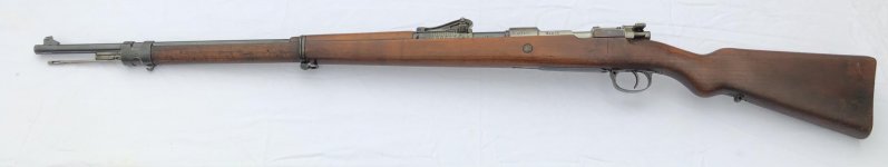

I posted this one before, when I first got it in 2014. Found it at a local gun store. It was dry, had some surface rust, and a cutdown stock, but it was matching and actually in wonderful shape under the dust and rust. Here are the initial photos and some very helpful information from Jon Speed: http://www.k98kforum.com/showthread.php?12590-Commercial-WMO-1917-1591
For six years I sat on the project, only oiling the metal, because I wanted to find the right stock, and Nathaniel was able to really help me out. I was able to repair it like any duffle cut, actually it was easier since I didn’t have to account for 1/8 inch of missing wood. The stock I got matches very well, glad I held out for the right one. Had already got the rest of the parts from Sam a while back so I was able to put it all together. I am quite pleased with how it turned out!
Paul initially speculated that WMO assembled it postwar using a salvaged receiver. Judging by the low serial it might not have been long after wars end, and the parts look to be not new made but rather salvaged wartime parts with 91 over stamped. Even the receiver has an over stamped serial, though it’s a little hard to see. The barrel might be a wartime reject, it has a faint S and a large A under the rear sights. The stock looks like a wartime spare as well, with indentations for where the acceptance would go. It’s internal serial does not appear to be over stamped, though the handguard is.
Overall it’s a very well made Gewehr. Even though it’s not military, I think it fits nicely into the collection.
