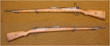

This rifle is actually hard to place in a category, as it spans the whole timeframe, from WW1 to WW2 Nazi!
Rather than bore you with a bunch of descriptions, I'll just post pics. Bolt handle is numbered 3147 but balance of bolt is numbered 42- a rework error I guess? Font looks the same! Note early "skeleton" style flat sight base. Also, handguard is E/359 inspected and numbered to match.
Looks like it went through a couple of reworks, Weimar Jt18 on the keel, Nazi Ws1 on the side. Barrel code and RR included in the photos for SimsonSuhl.

Nice, mrfarb, thanks for the pics. The renumbering is very interesting, but my favourite part is the font on 1920 property stamp.
I agree, a wonderful rifle and it truly does span the entire period as you say- most do not!
Clearly Imperial made originally, in inventory during 1920, early upgrade to S/sS (acceptance stamps and parts show its rather early), the e/6 wide rear band is a later upgrade too, then the nazi era for a final repair or inspection.
Amazing the original barrel survived it all- that is definitely the original Danzig barrel!
I hope you use that rifle in your Vol.I as it would be quite appropriate to illustrate what became of the Gew.98's that remained in Germans service, - not destroyed (as most were between 1920-1923) or sold to Spain.
Yes, this will be in Vol.1 and pretty much covers the history of the Gew98 rifle from WW1 to WW2, all in 1 package. I'm very pleased to add it to the collection. The bore is actually not that bad on it either!
