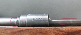

swjXE nailed it, total fake built from a postwar Czech dou marked rifle. Damn shame people are bidding on it at all, the signs are clear it’s fake by just a simple comparison. Bolt is the easiest thing to pick out, and the lack of top acceptance. Plus the fake looking barrel proof.
I thought this came up recently as a question also? Maybe a turd alert? I wonder if this is one of the rifles being sold by bigger online retailers also originally advertised as latewar German? The bottom metal would be easily swapped.
In the area on the left you can see where metal has been moved. The surface there just isn't uniform as are the areas all around it. On the right you can see the diagonal file marks they weren't able to completely clean up. Just based on 'where' those manipulated areas are you can figure out what was removed.
