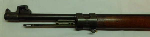

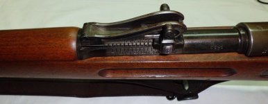

G98 Spandau 1917/18
Icarus8383

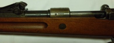

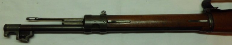

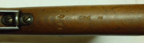

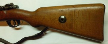

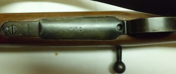

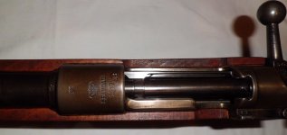

I took some time to look over both rifles. Both look quite nice, the Mauser Oberndorf is exceptional (rare in this condition too), very desirable. Personally I find it amazing it has survived in this condition, - though the myth nice rifles are unobtainable in Germany has been disproven many times. Some real screamers have come to light in the last decade alone... though the German government is doing everything imaginable to ruin collectible rifles with all those modern proof laws.
Re-the dot, yes early 1944 serial range, Brno ran consecutively 1943-1944, the serial switch over was in the mid-v block, though I believe many 1943 dated rifles were finished in 1944 (a very typical practice throughout 1898-1945). I can't say the pictures are wonderful or numerous enough, but what you show looks good to me.
If the choice is a singular one, you can only have one or the other, the Spandau/MO is by far more exceptional and rare, these are known in some number, probably a dozen or two of this type (Spandau receivers cycled through Mauser during 1917-1918) but no known example is anywhere near this nice. It is a real steal if the price is reasonable.
Will you look at that stock! That may be the nicest beech stock I've ever seen. As a gew 98 collector, off standard production is my favorite and what I seek out. This is one variant that has alluded me. Like Paul said, if you have to choose, pick the MO Spandau and don't look back. This one would be next to impossible to upgrade. I really like the slash date too, I've seen a few but were straight 1917s. I'm curious to see what firm made the receiver.

The RR will tell the receiver maker, but all but two were built on Pieper receivers, - a couple do not show the RR also.
Theoretically, the RR should be C/Z C/E C/E

This RR fully confirms this is a Mauser made rifle from 1917 which wasn't finished until 1918. The C/Z in the first position also indicates a Peiper receiver (Belgian made), the "Z" in German script is similar to a "3" in appearance.

You will see on the photos that the buttplate is unnumbered, which is not correct, is it?
Yes, the buttplate should be serialed in all cases, also a crowned inspector near the center of the BP. No suffix on Imperial rifles though. This changes only with the 98b in the mid-1920's, all Imperial rifles will not have a suffixed BP.
