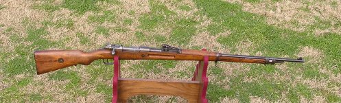

I don't think your Amberg has a actual two piece stock though, at least I don't see the tell-tale line running down the side of the butt. This reworked Spandau has a two piece stock, see the difference in the wood.
