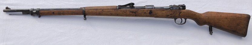

Don’t know any of the history of this one, got it in an auction with an awesome 1918 dated 98/05 bayonet, but it’s pretty nice for a ‘15 Schilling, only a few rough spots. It came covered in varnish, most of which I removed, but occasionally i find spots I missed. Worst part is that it’s in the acceptance stamps on the screws, and sort of obscures them, but I think they are c/B.
The buttplate indicates it went through Mainz at some point. Interestingly there is also a 6 stamped on the bottom of the stock. It’s matching except for barrel bands and striker assembling (and the cleaning the rod is number matching but I added it). The mismatched parts are all numbered 34 and are c/R from an Amberg, so I’m wondering if a lower level depot used the parts from a destroyed Amberg. Pure speculation, but I figure Mainz would have restamped the numbers.
From what I can tell by the acceptance, most of the components are Schilling, most importantly the stock and trigger guard. The barrel, rear sight, and some other parts are Sauer. Haenel supplied the receiver, trigger, front sight, and likely the screws. I think the bolt is also Haenel, but the acceptance is weak.
V. CHR. SCHILLING SUHL 1915

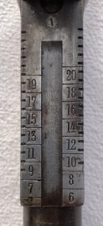

Rear Sight Leaf SN 96 c/N
Sight Slider SN 96, 96, 96 c/N

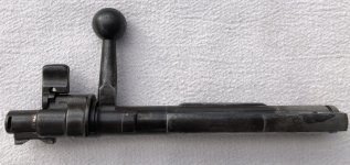

Bolt Body SN 5996b c/B
