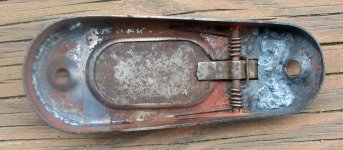

After re cutting screw slots with dremel managed to get buttplate off. As you can see its obviously toast, screws too. I saw the orig on e bay with the broken door, but not sure how to remove doors, is the outer sheet metal staked over the pin that the spring and door hang on.? Not sure if its do able or something I want to tackle. Ideas?

The door is pinned through the buttplate on the side. If you drive the pin out, the door will come off. Reinstall in reverse. Its not a hard job.
Yes that's what It looks like, however willing to bet there was fixture when these were made to keep sides from distorting Same with removing the pin. I think these were never intended to be a serviceable part. Since mine is bad anyway I will fit a block of wood to the inside to keep it from distorting when I try to drive pin out. Its soaking in Kroil at the moment. Still waiting to hear back from D.Weaver on his repro.

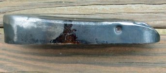

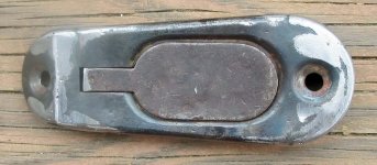

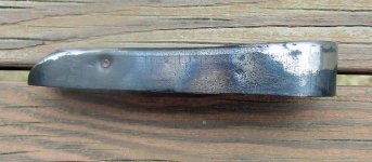

Tough to say. I’ve seen worn butt plates welded up and ground flush again. If you have access to a good welder, this may be an option.

This is one that I had welded up because it had holes in it just like yours. It needs a little cleanup but it should work. I really don't have a need for it at this time so if it's something you would consider, let me know.
