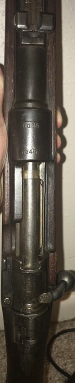

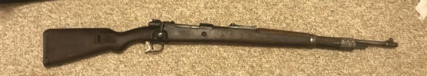

Hello, I recently got a k98 from Royal Tiger Imports. I'm not sure as to what kind of k98 it was, and was wanting to know what model it was, when, and where it was made. As you see, the "n" in what I'm assuming was "BNZ" and the "m" in "Mod 98" are missing. Also, the safety lever, and cleaning rod are missing, other than that I'm not sure. From everything I've seen on the outside, all the serial numbers say for some parts on the bolt are matching. Going to assume that happened while being transferred, like how some Type 99 bolts were taken out on the trip to the US. Below are pictures of the rifle, thanks for any help.
Hello! We need more pictures to evaluate what you have. BNZ45 is potentially interesting! Ideally we need photos of all the markings you can find on the rifle.
What was it advertised as?. The action was originally made by Steyr in 1945, but somewhere sometime since, it was partially scrubbed, renumbered, etc. Looks like they peened and defaced eagles while they were at it.

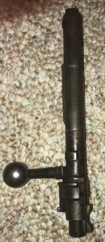

I think that the serial numbers on the magazine floor plate and on the receiver ring were added as well. Can you show us the bolt too please?
The only original and correct serial is on the barrel. The other serials have been added to enhace the gun. Note how the font is different, especially noticeable with the letter "3".
Yes this gun has been heavily worked over, and the safety is just GONE?? Eagles peened out all over, I think I’d try to return it.
Well I can't really see much with these pictures but I'll also add that's not the correct stock. Probably came off a Gustloff SK. Interesting for being able to examine what these RTI rifles really are.
