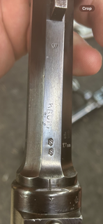

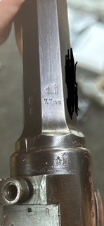

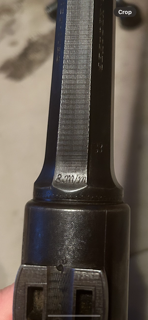

I've got to be honest, based on what has turned up in the other thread you posted about this gun I'd probably take it out of shooter contention. Too rare, not worth risking it. I don't say this lightly, I'm very much a proponent of shooting even valuable rifles.
If it were mine I'd probably cast the chamber to get a definitive answer on what it's chambered in and start the search to find replacement rings and optics to complete it. I might shoot it once or twice once I figured out what it it was in just because I'm incorrigible that way, but it certainly wouldn't be something I shot much at all. And even that would be dependent on really examining the hell out of the stock to make sure it's good to go. It would be a damn shame to crack that lumber.
