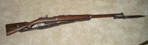

Origins of My Gew 88 Rifle
The original rifle had it’s beginnings as a German Commission rifle sometime prior to 1888 known as the Gewehr 88. It was designed by a group of officers from the GPK (GewehrPrufungsKomission) or Rifle Testing Commission of the German Army located in the city of Spandau. It was not truly a Mauser design, having a similar rotary bolt action, a Mannlicher design magazine feed system, and a steel jacket slipped over the barrel and screwed into the receiver.
At that time the ammunition designed for it was a round nosed 196-227gr. cylindrical bullet 0.318 in. diameter. It was a Cupro-Nickel FMJ with a smokeless powder load designed to produce a 2100 fps velocity. The caliber was designated 7.92 x 57mm J and became one of the most successful cartridges of the era. 7.92 mm or 0.3118 in. was the original barrel bore and the rimless case was 57 mm long. The “J” designation erroneously arose from what was originally an “I” designation which stood for Infantry, and so it stuck.
The rifle barrel had a 0.3118 in. bore and a 0.3189 in. groove diameter, tailored after the French Lebel design at the time. The bolt was a design derived from the 11mm Mauser Gew 71, modified by Louis Schlegelmilch, a Spandau Arsenal technician. An improved Mannlicher style five shot packet clip magazine was added along with a full length metal barrel jacket designed by Armand Mieg. It’s purpose was to protect the barrel from damage and hands from heat. The packet clip held five rounds and was discharged out of an opening in the bottom of the magazine when empty.
Field trials were completed in November 1888, and the orders to adopt the design were signed by Kaiser Wilhelm II that year. This was the G88. (Gew 88).

Second Modification 1935
Sometime during WWI, many rifles like mine were sold by the Germans to the Turks. The Turks refurbished these Commission 88 rifles in the 1930’s. My rifle, number 1286, underwent the following changes in 1935.
The barrel was replaced with a new barrel having the 0.323 in. groove diameter and new chamber dimensions for the “S” cartridges.
The barrel jackets were removed. Wooden hand guards were added over the barrel, surrounding the rear sight.
The stock was re-shaped to a pistol grip style.
The rear sight was changed from the s shaped slider track to a notched flip up pivoted slider.
The forward band was changed to relocate the bayonet lug mount from the side to under the barrel.
The rear sling band was retained by a spring lock rather than a screw for ease of disassembly.
And so it became the G88/05/35. (Gewehr 88, 1905 S mod, 1935 Turkish mod).
