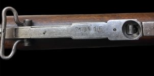

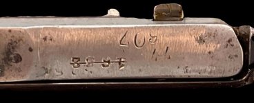

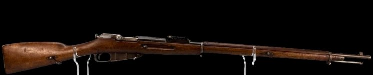

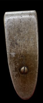

Here’s something a bit different but neat and within the focus of this forum. It’s your standard 1895 Tula Mosin M91 captured by the Germans. The gun passed thru the Koln depot as denoted by the “4” on the buttplate. Buttplate is original matching to the barrel shank too, so that tells me this is the original stock. Right side of stock has the Imperial German Deutsches Reich property stamp. Unfortuatley his one like many has been lightly “Finn’d” with added sling swivels and an SA stamp. The bolt was also renumbered to match likely by the Finns.

Very nice rifle Marc. The buttplate markings are an added bonus. This is a nicer example Finn. A lot I see were run hard and put away wet and as such are in much rougher shape.
What is for me little strange is the crown C on sling ring attached on triggerhouse front part. The rifle was certainly reworked even by russian as Konovalov sights and enforcement in buttstock behind the receiver nut.
I didn't notice stamp on the sling swivel. Any idea of its origin?
It could be german, but why stamped on sling ring?? Its strange, there was not reason to stamp a older captured gun this way. The system of inner springs in magazine is too from other weapon as missmatch, but this could realised in war or postwar by Finns.
