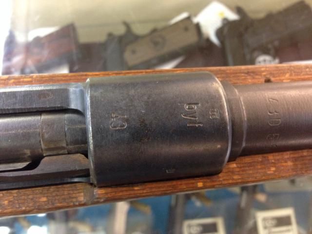

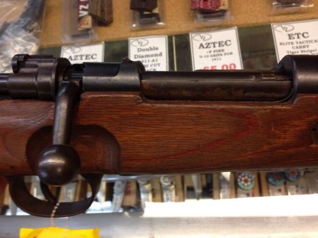

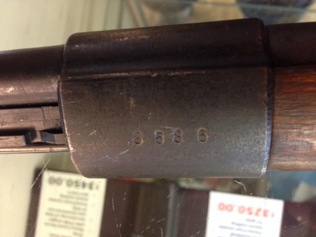

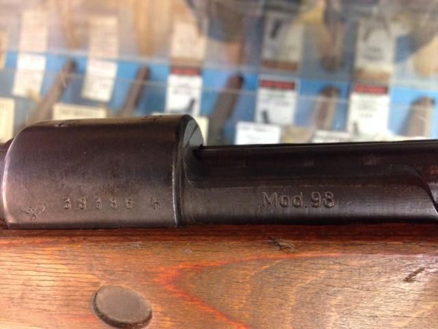

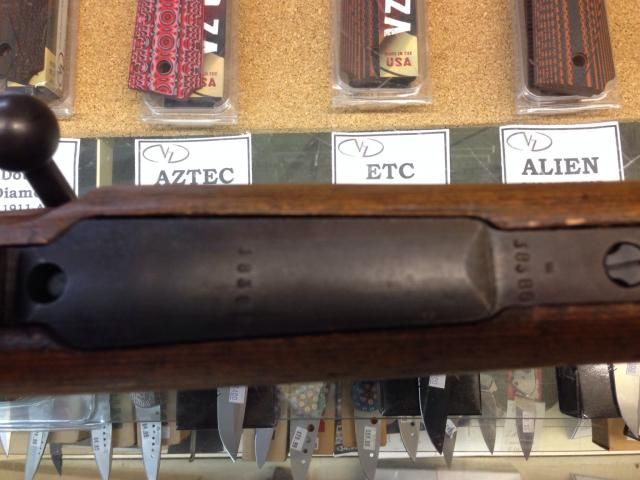

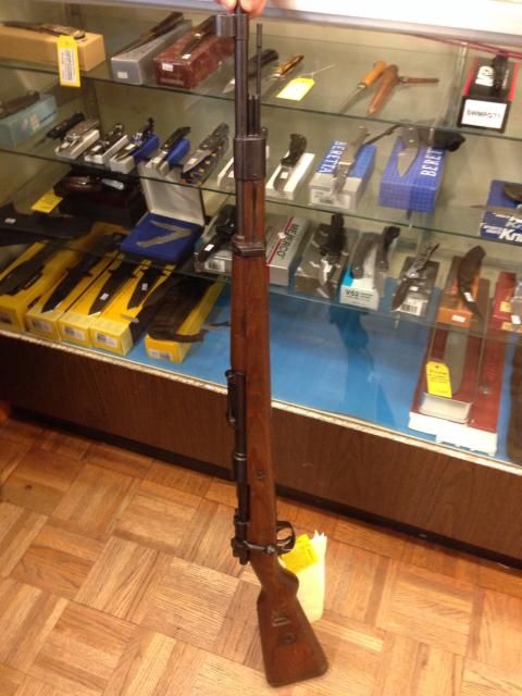

I've always wanted a K98 for my milsurp collection, to offset the mosins and enfields, finally found a beauty. Just put this K98 on layaway 2 days ago, and if it doesn't check out then I'll let it go. It's being advertised as a real non RC with good original finish. Okay- BYF 43, WaA 135, SN 38386h. Very nice bore with sharp lands and grooves, strong muzzle crown and bright. The bluing is older and shows some wear, but it's very nice overall. I am curious as to either a VERY lucky mixmaster, or a factory stamping error. Everything on the rifle matches the 8386 SN with the exception of the nose cap and barrel band, which are stamped 8586. Seems a little close, seeing the resemblance between 3 and 5. Okay enough jabber

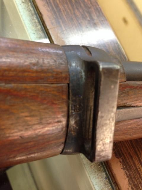

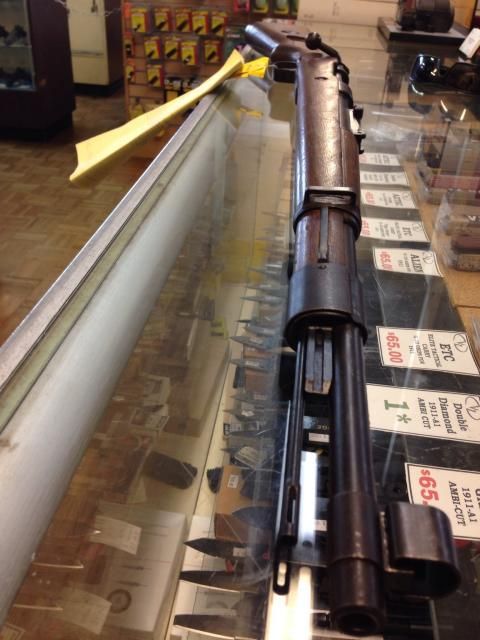

I searched all over for an X stamp or import mark, couldn't find one. Looks like whoever took the rifle apart last installed the barrel band on the wrong side, as the sling hole is on the same side of the bolt it does not have a welded nose cap. No evidence of prior shellac, just a dull oil like finish over a laminated stock with red glue.

Bolt side view

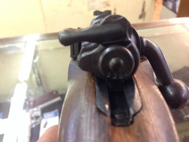

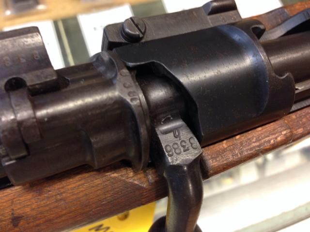

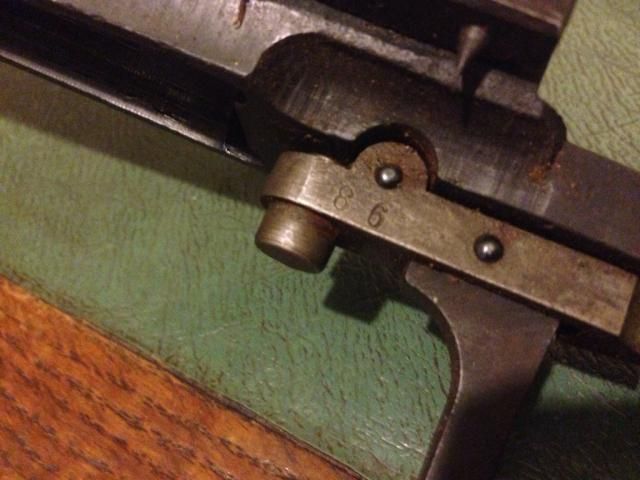

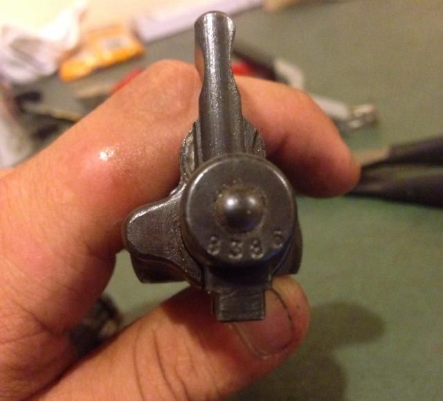

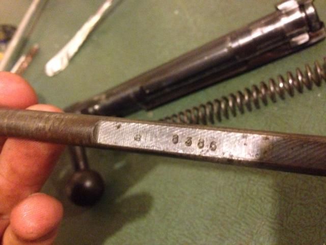

View of bolt handle and body, body is stamped 8386 and handle is stamped 8386 H. You can barely see the bolt release lever, stamped 86. Not pictured, but the back of the firing pin is stamped 8386.

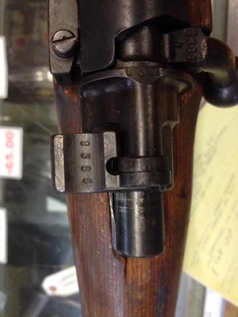

Safety switch, stamped 8386.

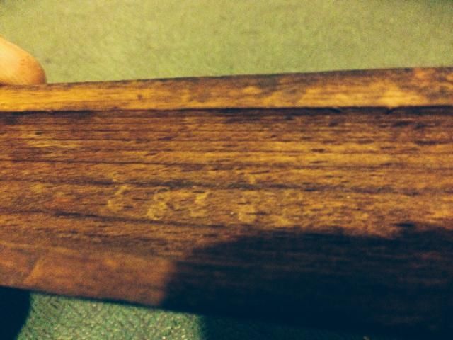

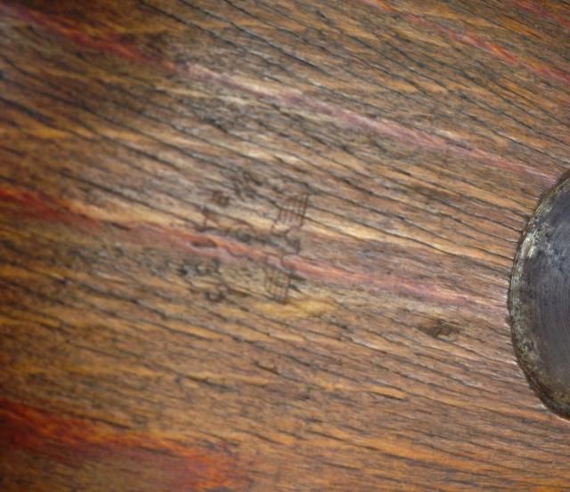

Stock marking, WaA 135. No other markings on side of buttstock. Not pictured, but the buttplate has WaA 135 on it.
Nose cap. Stamped 8586. Don't have a good pic of the barrel band, but it shared 8586.

The lower barrel band is mounted incorrectly, the sling loop is supposed to be on the left side. You should slide the barrel band forward and check for a duffle cut. Even if the two mis-numbered parts were not original, I would still take the rifle if the price is right.
Looks ok. The front band is almost certainly a factory error and these mistakes are not uncommon. Wouldn't bother me. What is the asking price?
Thanks guys, I really appreciate the input. I realize the band is installed incorrectly, I have not moved it to check for a duffel cut or serial numbers on the wood.

wHILE A BYF 44 IS ABOUT AS COMMON AS THEY COME, IT APPEARS TO BE A NICE, ORIGINAL MATCHING GUN, THAT HASN'T BEEN MESSED WITH MUCH IF AT ALL...
Sorry about the caps, caps lock was on...anyway, assuming everything else is correct, I would say if you want a nice matching 98k, $1100 isn't a terrible price at all, if I wanted one, and had the scratch, I'd buy it...
I agree the two misnumbered parts are factory errors...I wouldn't worry about them...

Congrats 81turbota, you did good. That has all the indicia of a factory mismatch/error. When you get it, check the handguard and stock. I have a bnz 43 with the same type of error with the bands.

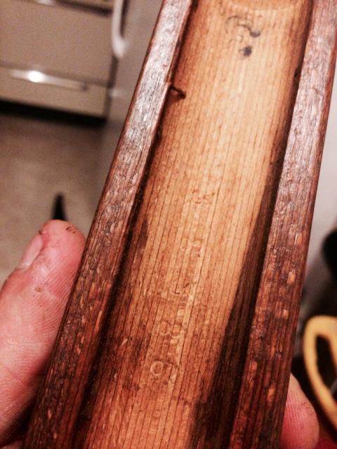

I brought it home today, and pulled the barrel bands off to check the stock.
Numbers matching! 38386! I'm pretty happy.

Congrats. I'd do little to nothing to the stock. Going back to look at the stock, I'd leave it alone, it's fine as it is. The MOST I would do is put a dime sized dollop of Howards Feed n Wax on a white towel and wipe the excess built up dust off and out of the grain. Others may differ on that, but I would do nothing else, if that, and probably wouldn't even do that. Well done, nice find. :happy0180:

Take Hambones advice on that stock, thats really a really, really nice stock, you don't need to do anything to it, except, maybe as Ham suggests...but thats it, they don't come much better as far as unmessed with.
