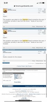

I thought I heard somewhere that this picture was from a TV show. Maybe Combat????? I can’t remember if it was this one or another photo. I’ll see if I can find the thread. It was on another forum.

Alund took these screen shots from the thread on gunboards where it was discussed.
Hollywood creation
Soldier appears Japanese (or Far East Russian) but his uniform strikes me as more Japanese than anything.

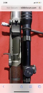

MC-1; it’s the marine corps version of the army’s M1-C rifle. The MC-1 used a stith kollmorgan 4x scope on the larger 1 inch ringed griffen Howe Mount. The M1-C used the m81 or m82 scopes on a 7/8ths inch mount as the army standard. Both mounts used the exact same scope base which was attached directly to the receiver sidewall. So one can make an MC-1 from an M1-C if they had the correct scope mount and real scope. The scope pictured in Dave’s “period sniper photo” above is a S-K with a 1 inch griffen Howe Mount (real or repro who knows) mounted on some Japanese weapon. The 2nd picture shown is a real marine marked stith kollmorgan 4x scope with a real g-h Mount. That picture is from one of the original rifles which came out of Quantico in early 70’s as an original confirmed MC-1. There are about a dozen of them confirmed.

Alund - you're joking right? Even though I don't have my reading glasses, I can see the large bent down bolt handle. That's not a M1 Garand but an 03A1 Springfield. Also note the large cocking piece at the rear of the bolt. That screams Springfield. Proximity of the rear sight to the receiver as well as the lack of rear aperture sights (like on the M-1C/M-1D) also says Springfield. The raised safety near the end of the bolt is also Springfield (but Mauser has this and the distinction of the cocking knob makes it not a Mauser). Note the bulge (top view) on the right side of the receiver. That also screams Springfield. Go to this link for another image of the receiver (never mind the sporterizing):

I suspect the scope mount is G&H, but there were numerous aftermarket scope mounts in the '30s-'50s and without seeing the mount, we can't tell. I do agree with the scope though as only the British and the Russians (OK, that suck Weaver M73 and the Leupold Alaskan) had turrets for adjusting for windage and elevation. The Germans and Japanese scopes lacked these features.
the scope not the rifle
I think we may be talking about apples and watermelons..... I am not talking about the rifle at all. I am only talking about the scope and mount. I could care less about the rifle. those scopes were only on the MC-1s I think you are talking about the rifle. I say what I am talking about again.... that is a stith kollmorgan scope and mount... whether or not its a military version, we will never know. Clearly that is not an M1 Garand, yes, I can tell that from the bolt alone.
