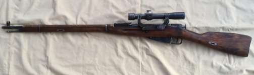

Nice, where did you find it? Since we're playing, here is my Finn PE with a repro mount
It came from a friend. I had to pay a big premium but I was willing to because I wanted one really bad it is the only factory original I have ever seen. I am sure there are others but not many so didn't want to pass on the opportunity.

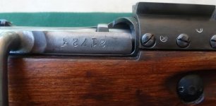

Thanks for sharing your rifle. Can you please post some more pictures? I would love to see the numbered parts and the inside of the receiver. Did it have it's original bolt? In my experience the vast majority of Finn captures had their bases and bolts removed.
What is wrong with it?
Jack
The bolt, floorplate, and buttplate have been renumbered. I am not certain if the 'СП' is real or not.

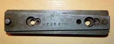

Scope base looks like it is a repro, and it shouldn't match the rifle SN in any case. Bases/mounts were numbered separately from the rifles, as crazy as that sounds. Mount is bad too.
The rifle was made to fool people, and its a reasonably competent job. Sorry to be the bearer of bad news...
Jack
I have to say Jack that I agree with Ryan. Look closely at your rifle. The bolt, trigger guard, butt plate and base have all been renumbered to match the barrel. They all display a different font from the barrel which they should not. The first letter prefix and No. 2 are the biggest difference. As Ryan pointed out the base is in fact a reproduction. I have attached a picture a real base for comparison. And originally the bases were never numbered to the rifle but to the scope mount. So that is your first give away. Unfortunately I have seen a few fakes that I believe were done by the same individual. Here are some pictures of a Fake 1936 PE. Look at how similar the serial numbers are to your rifle. And look at the stock acceptance. The Tula star is very strong yet no date can be seen.
