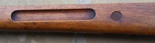

Lucked into this stock, saw it pop up, grabbed it real quick, looked good in the pics...figured from the way it looked better grab it.
I think it was a good grab, thing is untouched, unsanded, un-refinished, just a beautiful piece of lumber.
It is a DRP stamped stock...missing bayo lug, but rear spring, recoil lug and butt plate all there, as well as the bayo lug pin...but all are air rusted. But wood is just beautiful, raw inside, and finger grooves sling cuts, bolt cut out are all nice and sharp. Has that one little chip on the bolt cutout...
It looks like this takes a pinned front band, single spring rear band, what is this for, Standard Modell, Banner? Year?

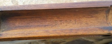

The stamp on the butt has the number 503667, but the stamp in the channel is 53667, fonts are the same, but no "0"...is this normal, or factory error?
I was debating dismounting the metal and working on the rust, but Flynaked says he'd leave it, what say the board?
Like I said, don't need it, but too pretty/nice to pass on, and maybe someday I will (need it that is...)! I think it'll be an awesome stock for some deserving action...Just don't exactly know what it would go on, the non-military 98's are something I know little about...

It would have a BannerK (basically a 98k), the receiver would have been a 1933 and yes the extra zero on the stock would not have been present on the metal or anywhere else on the stock. Not sure why they added the zero initially, but eventually they drop it in the stamp also.
I would leave it alone also, it is good material for trading, but I see no advantage to "fixing" things, some guys like the untouched look.
Nice stocks are always good to pick up if reasonable, they are like wooden cash (worth more that the crap in our pockets, dollars only hold value because all the other currencies/central banks are even worse)
Thanks for the info Paul, its much appreciated.
Yeah, I figure if I don't find a need, its good trade bait...I am sure someone out there needs it!
