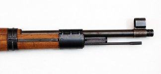

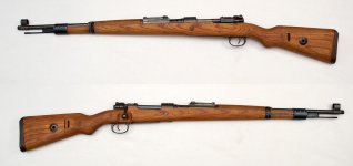

I have 1 bcd4 MG barrel rifle in the collection. It was actually one of the first rifles I ever bought from Gunbroker. We've all seen it, the guy who list a rifle for sale with a ridiculous price, and it sits there for literally years. Many times the photos are dark, out of focus, whatever, or they show exactly what you are getting and it's horrible. In the case of this rifle, the auction description was "mint bcd4", vet bringback, blah blah blah. No photos, and if you emailed the seller for photos you would never get them. So, I figured out the problem- his photos were so large that nobody ever saw them, as they would crash your system trying to download them in emails. I emailed him and asked for 1 photo, and it came through. The rifle was minty, phosphate, and had an MG barrel. A few other photos confirmed matching bolt, but alas the original stock was damaged beyond repair, broken through the magazine well to get it home in a duffel back, sort of a duffel bag break instead of cut. The original hardware came with it, as did a junker replacement stock. Fast forward 15 years, and I finally found an exact match to the original stock! It was by dumb luck, Bruce found a non-descript late bcd stock at auction, and missed out on it. He saw the same stock for sale online and ended up getting it, having seen the stock and knowing it was good. As he was selling it to another guy, he noticed the channel was cut for a machine gun barrel rifle-- they have a longer cut in the barrel shank area to allow the MG Barrel shoulder to fit. After working a deal with the other buyer, selling him a correct non-MG barrel stock for his, I got it. Now the rifle looks exactly as it came back, in a factory MG barrel late bcd stock with a disc. The odds of finding the exact correct stock are long, but it happened!
Here she is, in all her glory, back in action. For unknown reasons, quite a few MG barrel guns have standard type stocks with disc, at a time when other rifles in the same serial ranges were getting semi-Kriegsmodell stocks (many MG Barrel rifles have semi-Kriegs stocks on them too). I have a theory on that which I might share, and why you find a lot of MG Barrel rifles with stocks that are more finely finished than stocks of other late guns. It also might explain the mystery of why there are no 1945 dated MG Barrel guns reported, again at a time when bcd45 receivers were being used regularly.

Based on Weavers Volkssturm book, we know a lot of Luftwaffe MG barrels were released for building Volksgewehr sometime in late 1944, and probably early 1945. It seems plausible that Gustloff would not have assembled these components on the standard K98k production line, as the barrel component would require special adaptation to use on the K98k. My theory is a specific lot of receivers were sent with the barrels to a special assembly workshop, to fit the barreled receivers together. So, the receivers available and sent with the barrels at the time were bcd4 marked, as it was before introduction of the bcd45 receivers into production. It seems likely that this workshop could also have been tasked with modifying stocks for the special run, or developing the method to do so, and a group of stocks were sent as well. It's clear that serial numbers were stamped on the barrel AFTER assembly to the receiver, so the barreled receivers were probably sent into the standard production line once assembled. You do find regular bcd4 98k rifles with standard barrels in the MG barrel range, but they are few and far between. That's why I think the lot of them were dumped into the production line at the same time.
Some interesting sidenotes, there are no MG Barrel LSR rifles reported that are legitimate, meaning not humped up. I've seen a few pretty convincing ones, but the ones I have seen had issues. It makes no sense to build a sniper rifle using one of these MG barrels, so I'm pretty certain there are no legit LSR MGB guns, and no legit bcd45 marked MGB guns. If one is ever reported I'd want a good look at it. One thing I have learned though, never say never or you will get your a$$ handed to you. One other interesting sidenote, the later (after the serial rollover) MG barrel rifles all have the early type firing proof, while non MG barrel rifles after the rollover show the new style proofing. This is right in the adoption range for the new style proof, but interesting that none of the MG barrel guns have the new proof. I have an LSR in the same range as the MG Barrel guns and it has the new style proof (Sn 2189 I think). I should note that a few examples seen do not have the longer recess cut in the stock channel, so it would seem a few got by with the standard stock relief or these are restorations. I would imagine a few got by myself, it was almost 20,000 guns and there had to have been errors.
