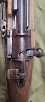

This one doesn't makes all the marks but here ya go. It is a Kriegsmarine bolt mismatch.
Happy to contribute.
1. S/147 1937
2. 2524 p
3. H marked stock
4. O. 6243
5. No discernable markings on buttplate, it's been very thoroughly beaten on and I believe it to be an armorer replacement. The whole butt end of the stock was replaced.
If any further information is required I'll be glad to add.

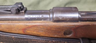

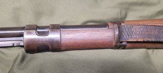

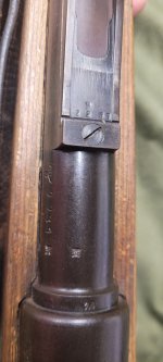

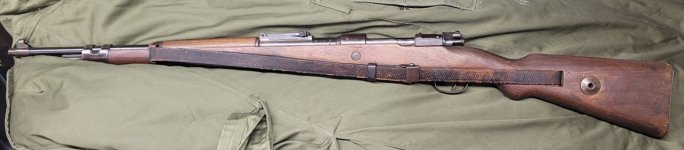

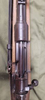

Here is my Salty, possibly still Salty KM. All matching as far as I know, never broken down.
1. 243 1940
2. 2231 r
3. M Marked Stock
4. "N" only - (No Numbers)
5. SN and Proof on Buttplate, no Naval Markings

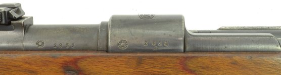

This is the Chinese contract divert.
1. Mauser Banner
2. 2832c
3. Stock service: Chinese Nationalist symbol with small E/M IIIb
4. Disk N 31015 k
5. Buttplate SN only
