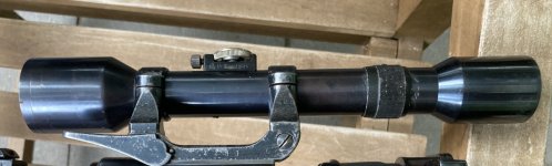

My personal feeling is that the SS Dienstglas engraving isn't original. The scope mount to me looks original.
most of these mounts have the HWZ logo not this commercial type hallmark. First ive seen like this ! Skull and SS dienstglas looks a bit off in depth and shape..
It looks to be an early SS Ajack that got enhanced. I agree with Absolut that mount looks OK possibly. I agree with Mauser and Absolut that the Skull and Runes is off. Probably added post war to make it worth more as a fraud marking. I personally would not buy it.

Must had missed one of the pictures earlier today. The view from top above clearly shows the marking on the scope tube for the focal adjustment zero. This is a feature of Swedish Ajack scopes only. Hence the scope tube is Swedish.
The Dienstglas markings are fake as has been already mentioned . Also notice it is missing the — between the SS Dienstglas . This SSR Mount with Weihrauch Logo is original . These SSR Mounts with Weihrauch Logo were used on/with SS SSR rifles but not often seen .
The elevation dial has not even been installed correctly. It’s too high and looks crooked in the photos. Would be interesting to know if lenses have a bluish hue when looked at in the light (coated as in Swede).
Years back, I found what looked like an SS Dienstglas scope consecutively numbered to one I had…. Once in hand, it was a modified Swede. The engraving on the elevation turret was fairly convincing, but the coated blue lenses gave it away.

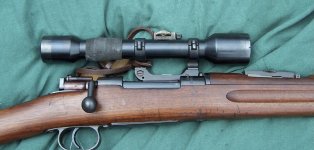

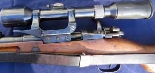

The Focal Adjustment Ring is Swedish type on scope in question . The Focal Adjustment Ring on German Ajack Scopes are different I attached photo of an original SS SSR Scope & Mount as comparison photos . Take particular notice just forward of knurled section of focal adjustment , the Swedish type is longer than back part , this is a typical trait of Swedish type .
Good catch Dave. There is a reason I had not noticed that difference before. Both of my Swedes have the issued rubber waterproofing sleeves obscuring the focal ring design.

In better light you can see the missing - between SS and Dienstglas.
But I have another question, I can not see any bluish hue, no matter how I hold the scope up to the light.
And the optic is very clear, the small blue reflection is my blue shirt.
Maybe a mix with german and swedish parts ?
