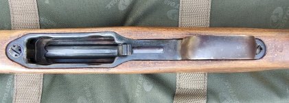

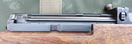

Hello, I recently purchased this Duv44 G43 from a collector friend of mine. All matching with unsanded stock with a mint bore, but missing cleaning rod. I’m new to G and K43, so any opinions are welcome. Hope I got a good one.

Agreed, very nice example. However, Yale and Towne Mfg. C. Leitwerke, Velbert, Heidestr. ("awj") only produced "K43" marked magazines. The magazine pictured appears to have a non-period "G43" overstrike and is partially repainted. Sad to see a fairly rare magazine ruined like that.
Thanks about the rifle, bummer about the magazine. Does anyone have a nice proper magazine and maybe a nice cleaning rod?
Nice rifle. It's not easy to find early BLM rifles. I like the thread muzzles. Thanks for sharing.
depending one what you paid you did well.. These early Blm rifles arent easy to find in nice shape.. Your close up photos are blurry. I know how hard it can be to take nice close ups. This is a b block..
The mag I would do more research before passing it off a messed up mag. I find it hard to believe its been restamped..

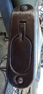

The only thing I can pick up on is the butt plate is the later type with the smooth door and this rifle should have a ribbed door type. Hardly any reason to not buy a rifle.. Could have been changed out during the war ?
Overall very nice and worth keeping !
Looks like a really nice one to me. I’ll have to check on my BLM serial number listings and see if it’s ever been reported (at work right now). I can’t see how the mag has been re-stamped either. It looks right to me. Agreed on the smooth butt stock door. The smooth is a little later, but who knows how the later got installed. The lack of cleaning rod and butt stock door are nothing to worry about. Easy fixes, but may be a little bit finding them to replace. Hopefully all is correct with the internals. Nice rifle.
Thanks all for the information and viewing my new G43. I Feel better about the 3,000 dollar purchase. Just purchased a cleaning rod, thanks Titan for the update on the magazine, wasn’t sure about it.
Looks like I need to walk back my earlier comment on this post. I am quite surprised actually – neither Hitler’s Garands or Rough Forged state the existence of such magazines, although Mr. Weaver does indicate by way of a footnote that “gcb” “G43” marked magazines are rumored to exist. It is hard for me to believe that no article, book, publication, or magazine study that I can find identifies this variant.

Good looking rifle...I wouldn't change the butt plate or assume it isn't correct. It very well could be completely original to the rifle and just an example of the transition from ribbed to non-ribbed. I believe G43's from multiple serial blocks were constructed at the same time...pretty sure I've seen this discussed before... so it isn't inconceivable this rifle is an example of a rifle which was actually built later than the block might initially indicate.
Just for reference here is my DUV 44, which came from a well known collector here...it is an "H" block with smooth butt plate
