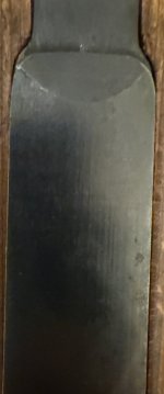

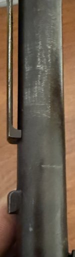

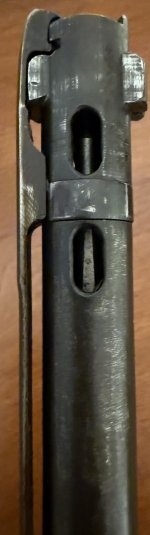

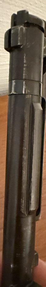

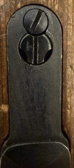

Any list or example of where else to photograph. I’ve tried to include more overall shots but the server won’t let me.
1) Left side of front barrel band
2) Underside of handguard
3) Bolt root top, bottom and back. (Example pics below of a numbered bolts and parts so you know where serials would have been)
4) Bolt parts like both sides of the safety, back of cocking piece, sides and top of bolt sleeve
5) Few more close up of the front of the triggerguard and floorplate.

@Mauserguy85 Some of these might not be good enough. But here they are. From what I can see with just a light in the breach rifling looks sharp. I don’t have a scope. I would expect a little rust and such. It has been stored for at least 30 years at a time without cleaning.

They are good enough. Just would like to see the top of the bolt root as well. That will tell a lot about the bolt. Also the firing proof is located on the back. You posted pictures of the front and bottom of the bolt root. In order to get a pic of the firing proof on the back of the root, you will need to disassemble the bolt parts from the body….
To do this (if your not familiar), make sure no rounds in the rifle, close the bolt on an empty chamber. Put the safety into the vertical position. Pull the bolt open. Pull the locking lever on the back left side back of the receiver open, slide the bolt out completely while holding the locking lever “open”. Depress the plunger (it’s spring loaded) on the bolt shroud and hold it down you screw out the back of the complete bolt guts counterclockwise.
Hopefully these are what you’re looking for. Only marking I’ve seen on the bolt is the last picture.
