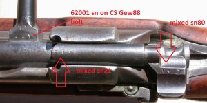

Present a german marked bolt G88 with arabic serials made in Zbrojovka Brno, when You have one? certainly it could be refurbish in 70 years in Turkey, as czechoslovak G88 bolts were corectly serialed on all parts with old arabic digits (on small parts with last 2 digits) and proofed with halfmoon. There exist minimum of 30000 Gew98 bolts delivered in same way and marked too similar way.
Mixing of parts is second name for Turks, here from thread of forum a CS G88 new replacement bolt with missmatch parts, similar occured on barells and other parts of G88/05 by Turkish service in 1920-1970.
