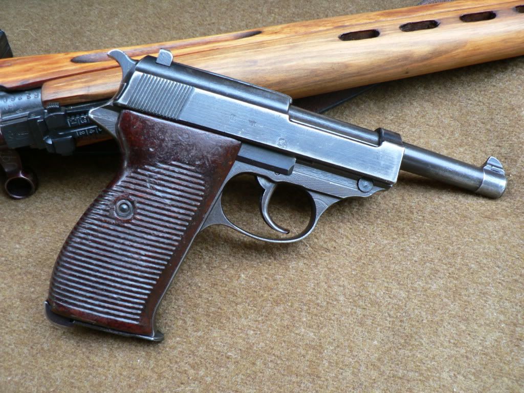

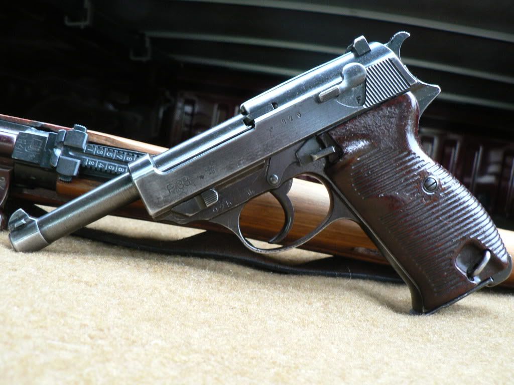

In my humble opinion the "steel" facts are that is a legitimate all matching German WW2 SVW45 P38 with all the correct markings out of the known or documented serial number range. STOP

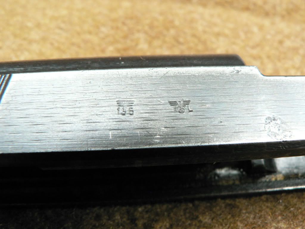

Forensic evidence of markings.
Cold steel markings on the pistol in question and my Police guns.
There may be more "cold steel" comparisons for markings being posted later by Ron.

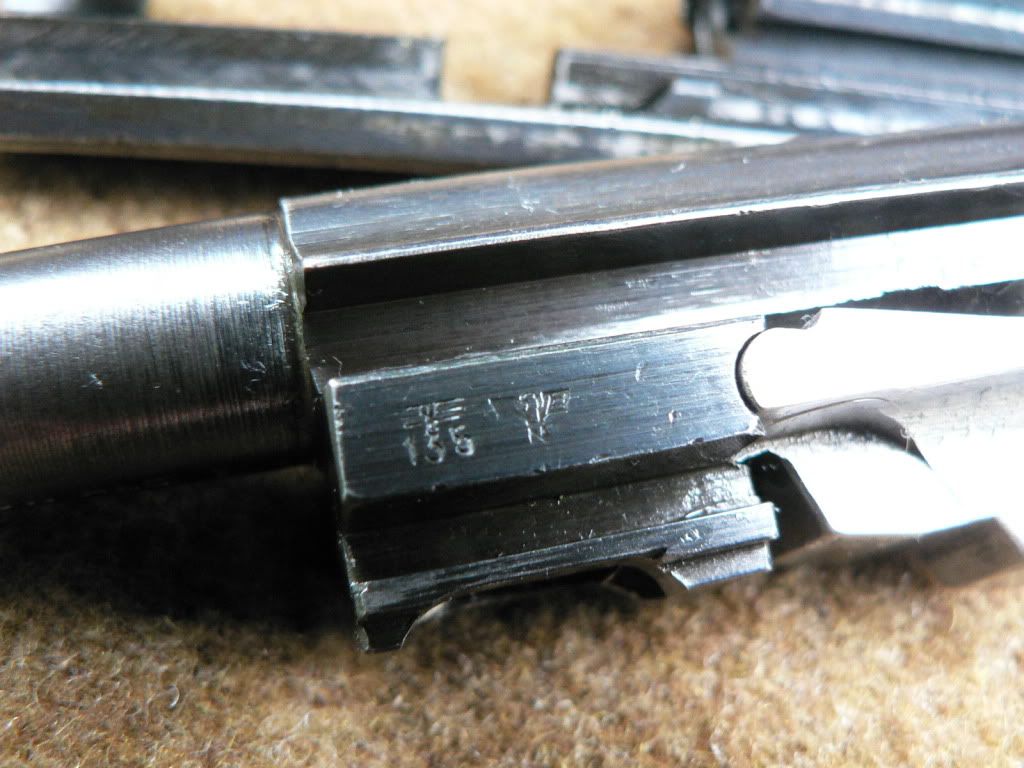

Gentlemen look at the photos and decide, the commercial stamps are not the same.
Notice the eagle on my pistols is centered over the "N", the pistol in question is slanted. Look at the eagle beak on my pistols and the one on the pistol in question, look at the space under the eagle wing for the "feathers" on my pistol and the one in question. Look closely on the photos and then comment, are they the same markings?
The German stamps got more worn but never deviated with the style.
So with photo evidence of the two styles of e/n markings can you still defend your stance on the gun?
Can anyone refute my point? This is not paper documentation but photographic analysis.

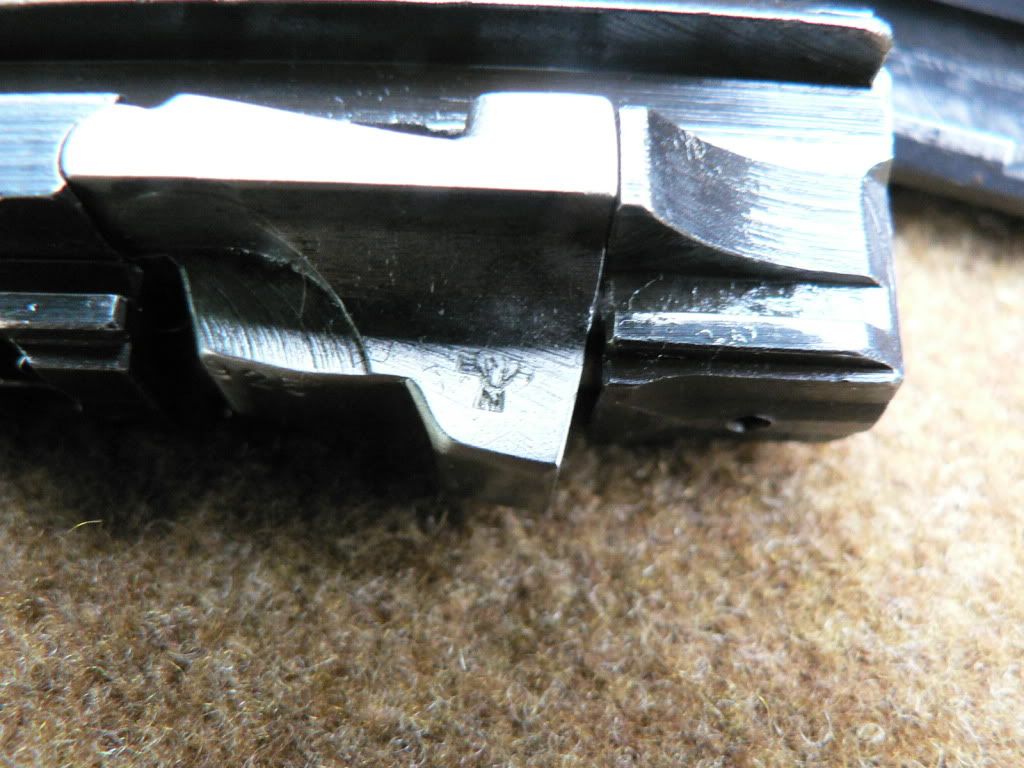

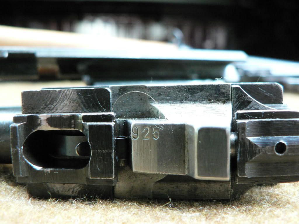

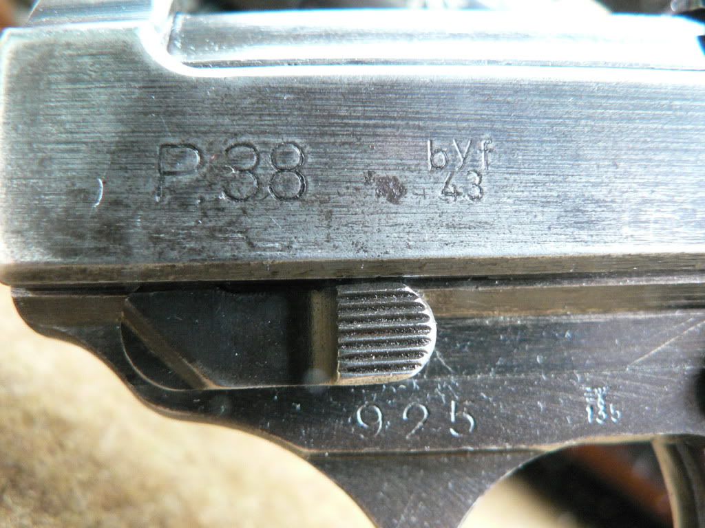

Easy. They had and used more than one stamp. Look at the commercial stamps on the barrel and locking block. They are identical to your short winged type.
Here is a BYF43 Police pistol that I have since given to a friend of mine. Notice that the commercial stamps are not identical to each other. They had more than one commercial stamp and there were variations:
Hmmm .. OK where is your evidence? I do not see the side by side comparisons ... should I take it apart for the the intel, you need to do work to show they are the same as yours.
I have presented this in a format that most collectors and visitors will appreciate. So produce some photographic evidence your point works with "cold steel"
I am just working on comments from other great collectors who want the "cold steel" rather than paper.
My photos stand with my original statement, a parts gun with questionable markings.
Now go ... what evidence of "cold steel" do you have to support your theory on this gun?
I don't have the time or initiative to show the e/n markings are the same as your pistol.
It is your turn to show me I am wrong.
Mark

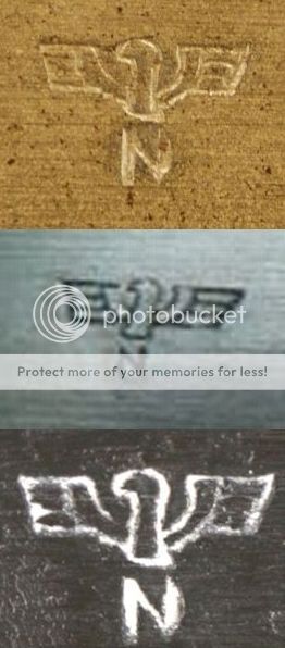

The eagles you picked to post curl up a bit at the top tip of their stubby wings. The BYF43 I posted has the type with longer wings that do not tip up at the tip on the slide, just like the SVW45 I have. Again, variations in dies. They used multiple dies not just one over and over.
Gentlemen,
I did have time to further study these markings today after work and will present a photo merge here.
Both the top and bottom photos are from known to be correct late war Mauser police contract pistols. The top photo is SN 5136 and the bottom photo is SN 4650. Both carry the Eagle over "N" commercial proof mark of the stamp used on these Mauser pistols during this time period. The middle photo of this merge is the pistol posted here on page one. The top and bottom photos have identical characteristics in common, the center photo does not have these same characteristics.
Some observations and comments; Note the shape of the neck, the head, and the beak, of the eagle on all three photos. Also note the shape of the wings on all three. The shape of the neck, the head, and the beak, of the eagle are the same on the top and bottom photos. They are not the same as the middle photo. The wings of the eagle on the center photo are very straight across with heavy horizontal lines, while the wings on the top and bottom photos contain slightly less detail. This can be attributed to the wear of the original stamp. Also note the slightly upswept tip of the wings which is more noticeable on the tip of the right wing.
Particularly noteworthy is the shape and size of the letter "N" and the wear patterns which are consistent with the overall wear of this stamp. May I draw your attention to lower right portion of the letter "N" at the bottom tip where the vertical line and angled line come together. They are identical. I don't think I would be going out on a limb here if I said that the stamp used on the pistols shown in both the top and bottom photos was one in the same. I have studied close-up detailed photos from four other examples from the collections of two other moderators from the P.38 Forum, one advanced collector, and my own collection (confirmed under lit magnification) , and all have yielded the same result.

Mark, all you are doing is picking commercial proofs that are of a different variation than the one on the SVW45 slide. Compare the ones you posted to the eagle on my locking block and barrel. They are identical. Then look at the fact that both my barrel and locking block are stamped 44V just as my slide is. For my barrel and locking block, they used up a die that has shorter wings with turned up tips....just like yours. For the slide, a longer winged variation without turned up tips was used. There is no conflict here. You are simply comparing apples and oranges by picking another die variation and then comparing it to mine to say it is "questionable." In other words, you are comparing two different dies. Who knows how many different dies were used? Nobody. That has been lost to history. But there were most assuredly more than one or two or even three.
Ron, the same argument applies. Look at the stamps on the BYF43 I posted. They do not look like yours either yet that pistol is real and original too.

Mark, even the four Mauser police pistols you show on your site show variation.
It is not speculation on my part to say that different dies were used...all ANYONE has to do is look. There are long wing and short wing types. Turned up tips and straight tips. Messed up N's and non messed up N's. Eagle head shape differences and probably more that I have not seen.
