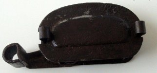

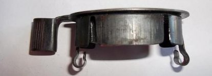

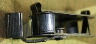

Detail of REPRO ofh for comparison:

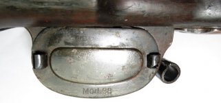

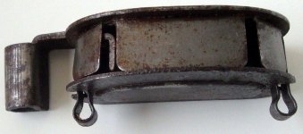

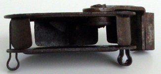

repro or real ?
Hi Guys,
I would like to ask you for help
Is this Winter triggers real lor it is repro?
It is not my field. I have got it free
Thank you
Stan

doesnt look good..
its not one im familiar with but it doesnt have the tell tale signs I look for quick on a real one...

Waffenamt looks like WaAU38, and appears to be the same as the other WaA example posted above.
Also of interest, the method/tooling used to press the rivet and the boxed Mod.98 looks identical to the 'ofh' examples. Perhaps an earlier variation from the same manufacturer?
