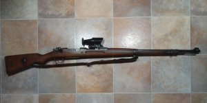

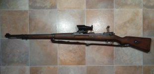

Amberg 1918 n.4663 e : the serial number of this rifle was already reported from Amberg , now here you have some photos .Unfortunately , due to local pitting , it's readable just the serial number on the barrel . I have completed the rifle with Glasvisier N.5048 .
other photos :
Seems you finally found the rifle to your scope! Congratulations!
